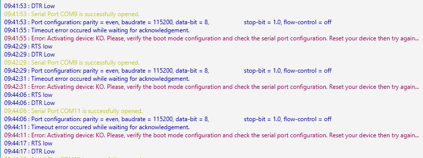

For the RAK11160, the module occasionally does not enter boot mode during firmware upload. In most cases, we can recover it by using the RAK Firmware Upgrade Tool to flash the factory firmware (rak11160_latest.bin). If that does not work, we use STM32CubeProgrammer over UART to erase the flash and program rak11160_latest_final.hex. After that, we are able to upload our application again from the Arduino IDE.
However, after repeating this recovery process multiple times over the course of development, the module eventually becomes completely unresponsive. At that point:
  • Our application no longer produces any output on the serial monitor.
  • The module cannot be detected by the RAK Firmware Upgrade Tool.
  • STM32CubeProgrammer is also unable to connect to the module.
We have observed a similar issue with the RAK3172. During development, we were storing application data in flash using api.system.flash.set(offset, buf, len). The write frequency was relatively low, so it is unlikely that the flash endurance limit was reached. Nevertheless, after some time, the module also became completely unresponsive and could no longer be accessed using either the firmware upgrade tool or STM32CubeProgrammer.
Has anyone experienced a similar issue with either module? Is there any known recovery method when the module is no longer detected by both the RAK Firmware Upgrade Tool and STM32CubeProgrammer, or could this indicate a hardware failure?

If using STM32CubeProgrammer over UART, you need to connect the BOOT pin to VDD, issue an power cycle or reset before STM32CubeProgrammer can connect to it.

We are programming the chip using the usb-ttl converter over UART.
Yes, we can recover it from that state using the stm32cubeprogrammer, and then after erasing the flash memory completely, we flash RAK11160_latest_hex and after that it starts working fine.

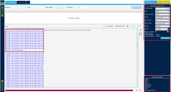

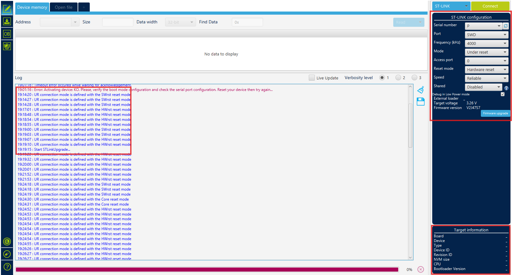

But at one point, chip stopped responding, even stm32cubeprogrammer could not connect with it over UART, or SWD.

Tried with Jlink
Pins Connection
STM               --->  JLink
ST_SWDIO    --->  SWIO
ST_SWCK     --->  SWCK
VDD_ST        --->  3V3
GND              --->  GND
ST_RST         --->  Reset
Tried diff speed (400kHz, 1000kHz) but everytime it gives error and failed to connect
Using JFlash
STM32CubeProgrammer Selecting J-Link
Seems your devices are damaged. Can you share the schematics, you can send to me through direct message.
