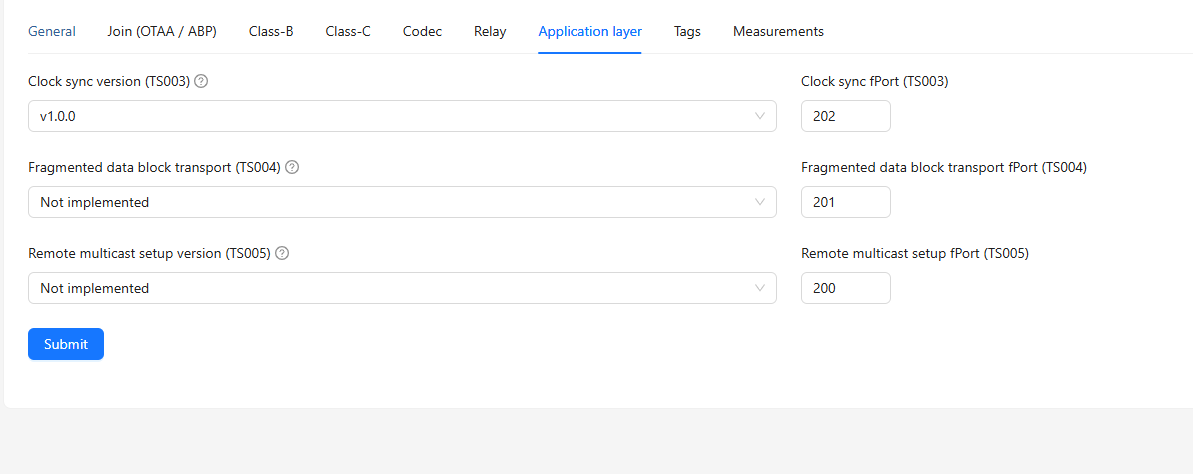

The nodes also synchronizes their time with it’s corresponding callback and the api.lorawan.timereq.set(1); api call
I leave this section as is:
Regards
Question about LNS came from our R&D engineer. To make sure he uses the saem test environment.
Application layer is only for FUOTA.
These settings are not used during normal operation.
