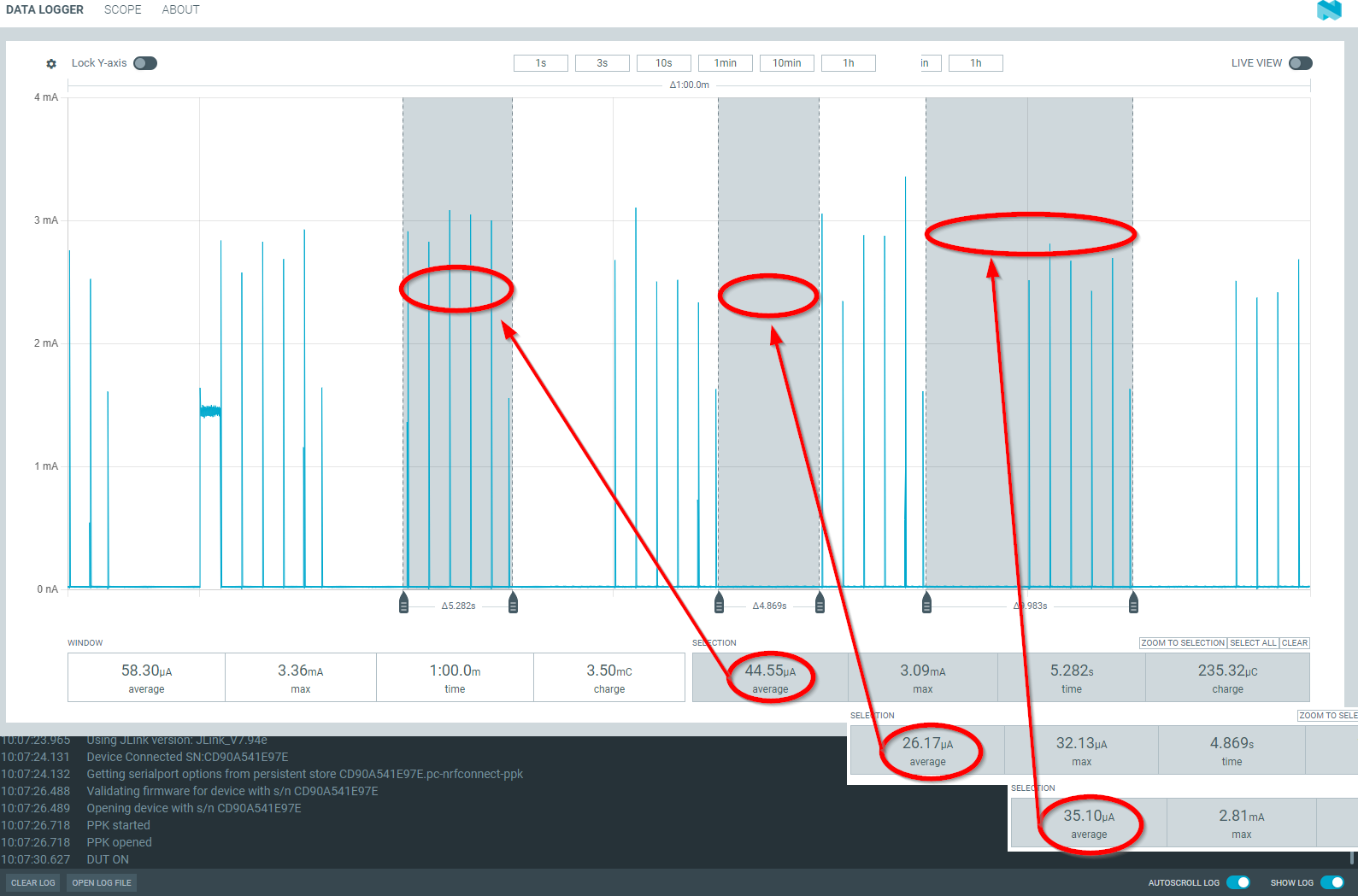

Some measurement with a WisBlock RAK11722 Core module, not best for low power, so just look at the differences between advertising active and deep sleep:
5 seconds BLE advertising every 10 seconds.
44.55uA during 5 seconds advertising
26.17uA during 5 seconds sleep
35.10uA average with 5 seconds advertising, 5 seconds sleeping
Test with LoRaWAN Class A, joined network, BLE TX power set to max.
