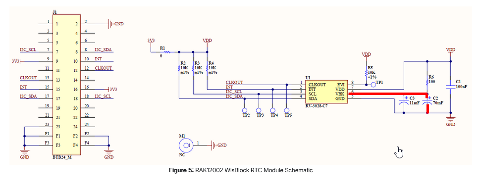

The schematic of the RAK12002 show the super caps charge from 3V3 (not 3V3_S).
When i have a RAK4631/RAK19001 and the 4631 spents 99% for the time deep sleep, is 3V3 bus still powered and charging the caps?

Hello @sspw,
We are having a similar issue with our devices, researching a little bit we noticed that R6 in rak12002 is not populated! (@beegee I would really appreciate your comments here) This is a real big problem, cause the supercaps are being charged via this resistor! Next week we are gonna solder this resistor and also add a Schottky diode in series with it so the supercaps will only distribute power into the RTC and not to the whole VDD power rail when the VDD voltage drops under the supercaps voltage.
We are gonna test with different VDD voltages from an external power supply and see at which voltage the RTC is losing time (first with the module exactly as it comes, then with the hardware changes).
I will post the results here! Regards!

Hello @felmue, our code doesn’t enable the trickle charge, I didn’t know about that feature, thank you for the advice! Regardless of that, is really weird that the guys left the pads with the resistor unpopulated but maybe they were thinking about using that trickle charge… We are gonna try that feature also and see how it performs, if it works as it should, then we can use it instead of populate every device with the diode + resistor combo. Thank you very much!
Charging is through VBK with trickle charge enabled.
If we connect R6, the super cap would power the whole board when it is not supplied from external.
so R6 is ment to be “not connected” to just power the RTC module and not the hole board (RTC + 19007 ? ) ?
The super cap doesn’t have the capacity to power the whole WisBlock.
If R6 is populated, the super cap cannot be used and on power cycle the RTC will loose its time and all settings.
