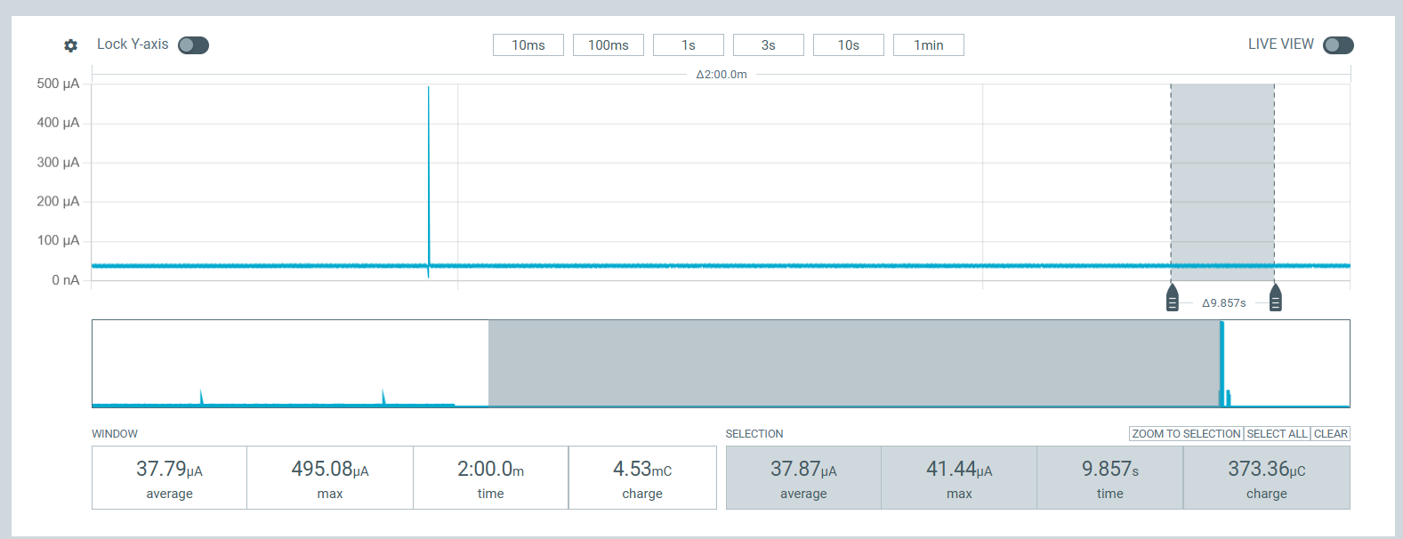

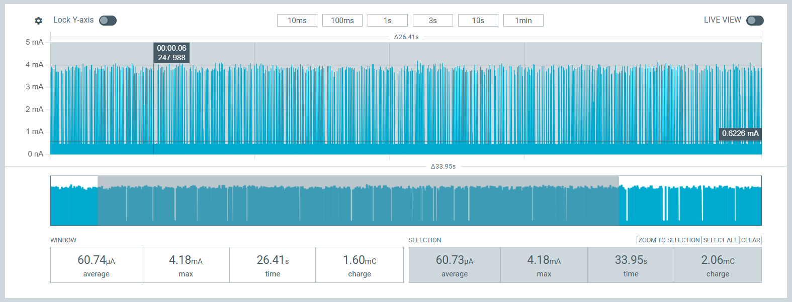

Hi,
Could you help me verify if a power draw of 13011 while in sleep mode is normal?
If I disconnect it, the reading drops automatically.

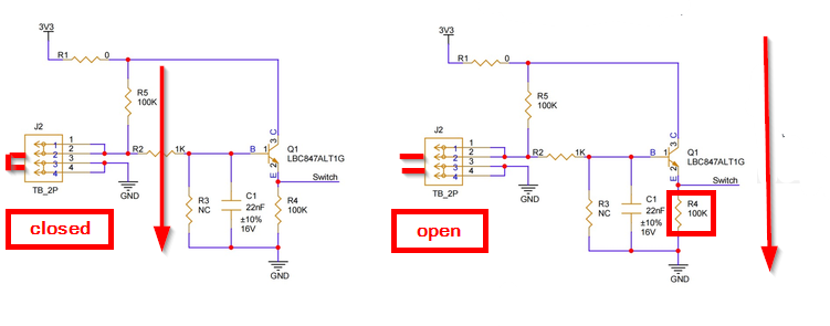

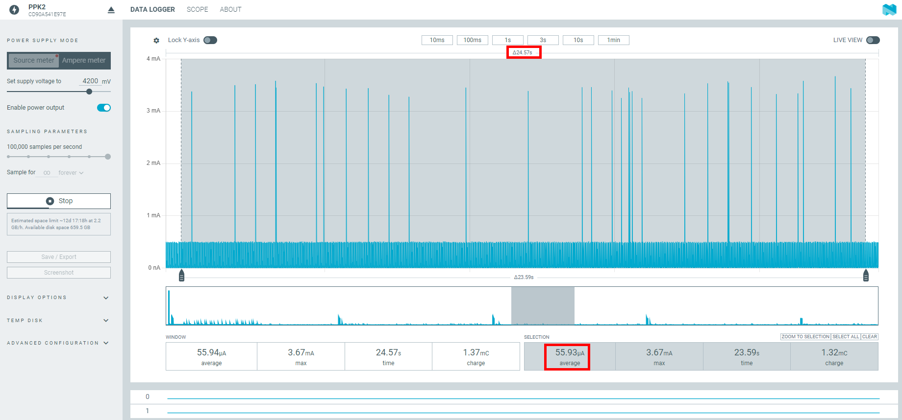

The measurement looks like the RAK4630 is permanently waking up. Could be caused by false interrupts on the RAK13011. (didn’t look on the time resolution, you recorded for > 20 seconds)
Run a quick test, average consumption 56 uA, so similar to yours.

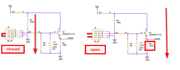

Hello beegge,
So, this behavior is normal, because the RAK13011 is always powered by the 3V3S rail, waiting for an interrupt to send an uplink.
Alternatively, you could check with the development team regarding this behavior of the RAK13011.

RAK13011 is not connected to 3V3_S. It is connected to the permanent 3.3V supply.
If the switch is open, you have current going through R4, roughly 33uA + the current taken by the base of the resistor.
If the switch is closed, you have roughly 33uA going through R5.
