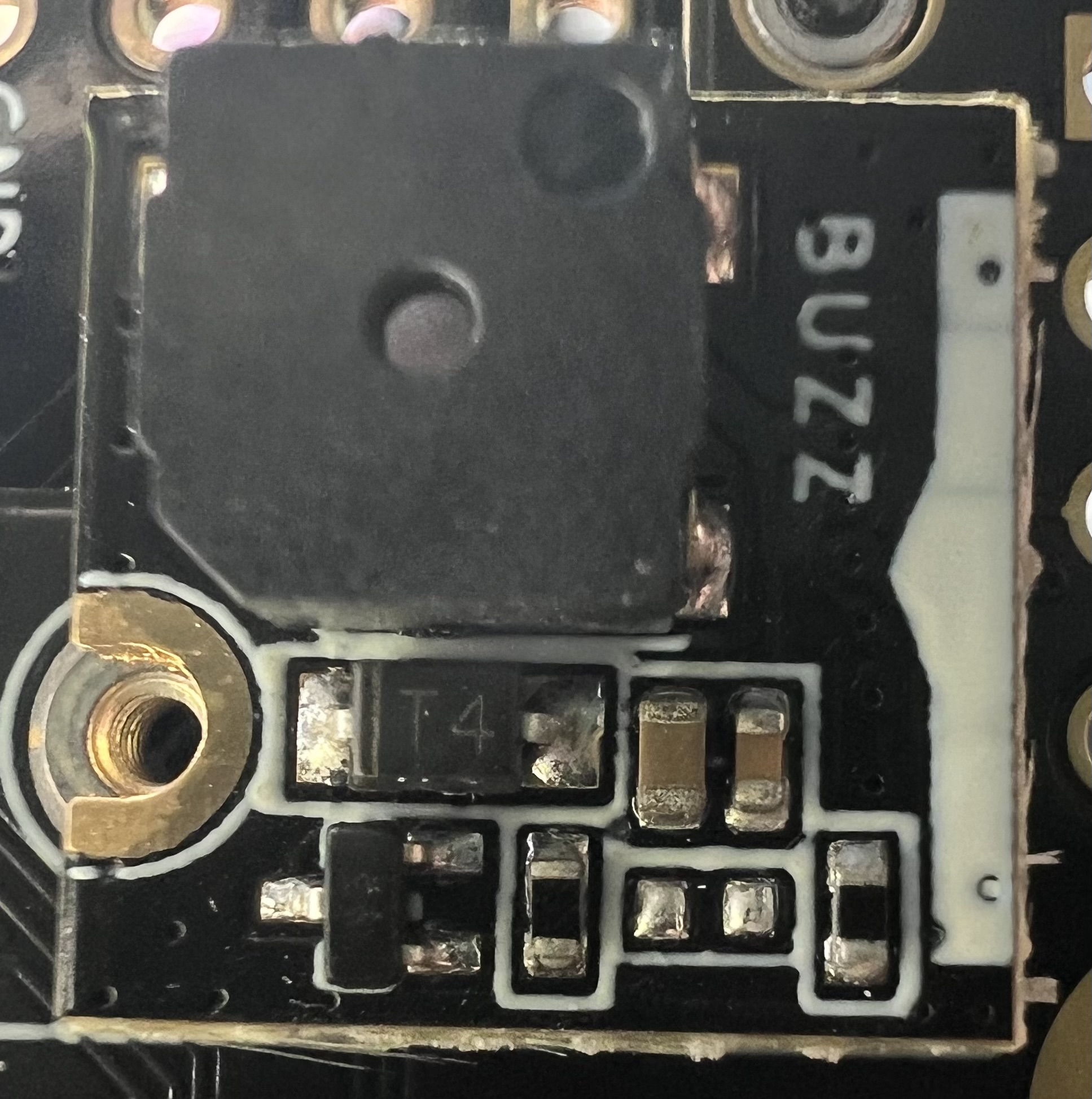

Your video was useful though, my buzzer does look like a different model, more components in a different layout if that would make any difference.
This is the link I purchased from, product picture matches your buzzer also for what that is worth.
https://a.aliexpress.com/_mK6mI3r
