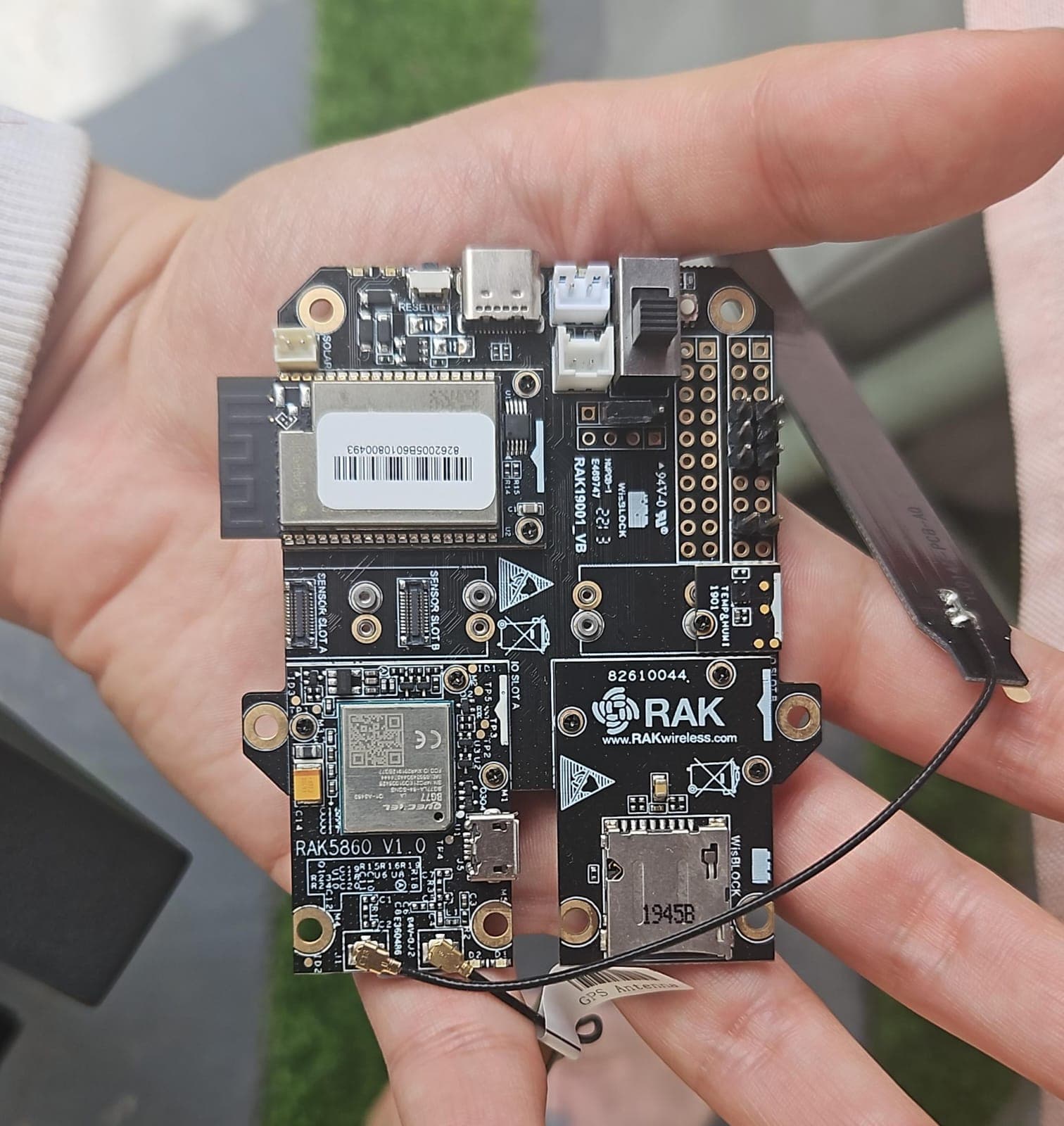

im using the RAK19001 for a project related to Narrow band and i was wondering if there is a way of programing the device so it could be turn off for like an hour and then start up again? this is with the intend to save battery power. I could also use a power saving mode or something like that.
Thank you su much for your time.
What WisBlock Core module are you using?
hi! im using in the io slot A the RAK5860 v1.0 and in the B slot im using RAK15002 SD Card Module
and im also using an Espressif ESP32.
You could use the deepsleep function of the RAK11200 (ESP32).
Here is an example how to use it ==> ESP32 Deep Sleep with Arduino IDE and Wake Up Sources
