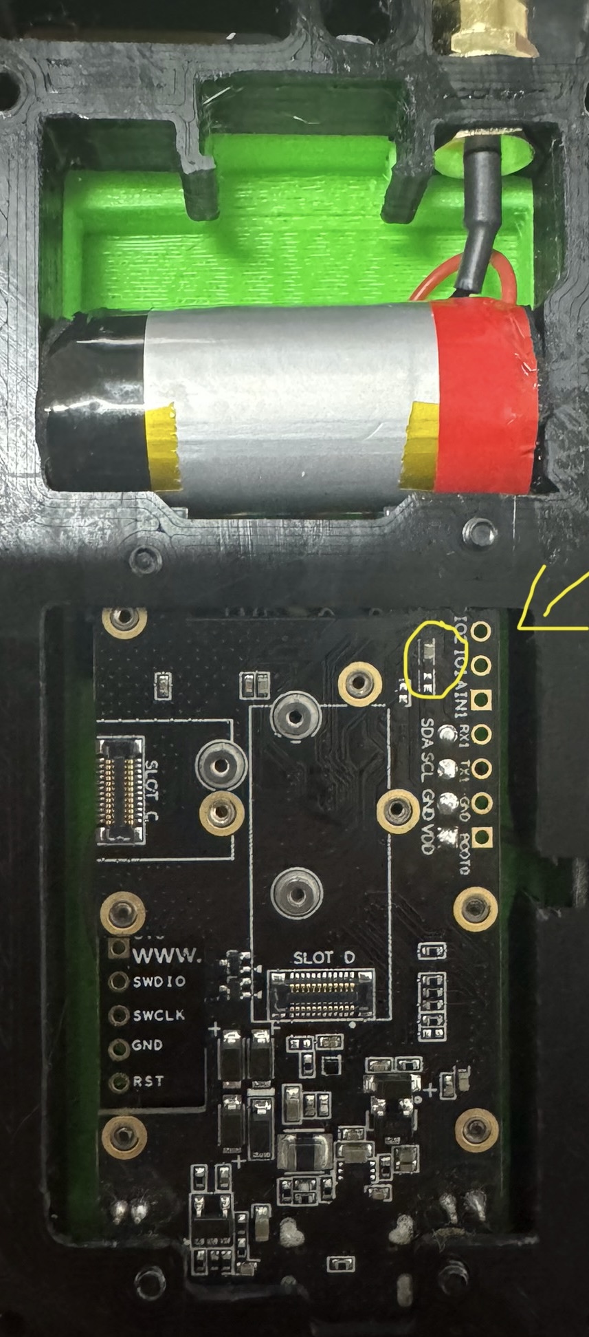

Hello guys, I’m not getting any luck with rack wisblock.
My first board I just fried because of wrong battery polarity. So, I ordered another 19007 and reassemble.
Every thing went well for about 2 days and the board died!
I can see that one resistor is becoming extremely hot.

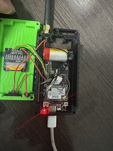

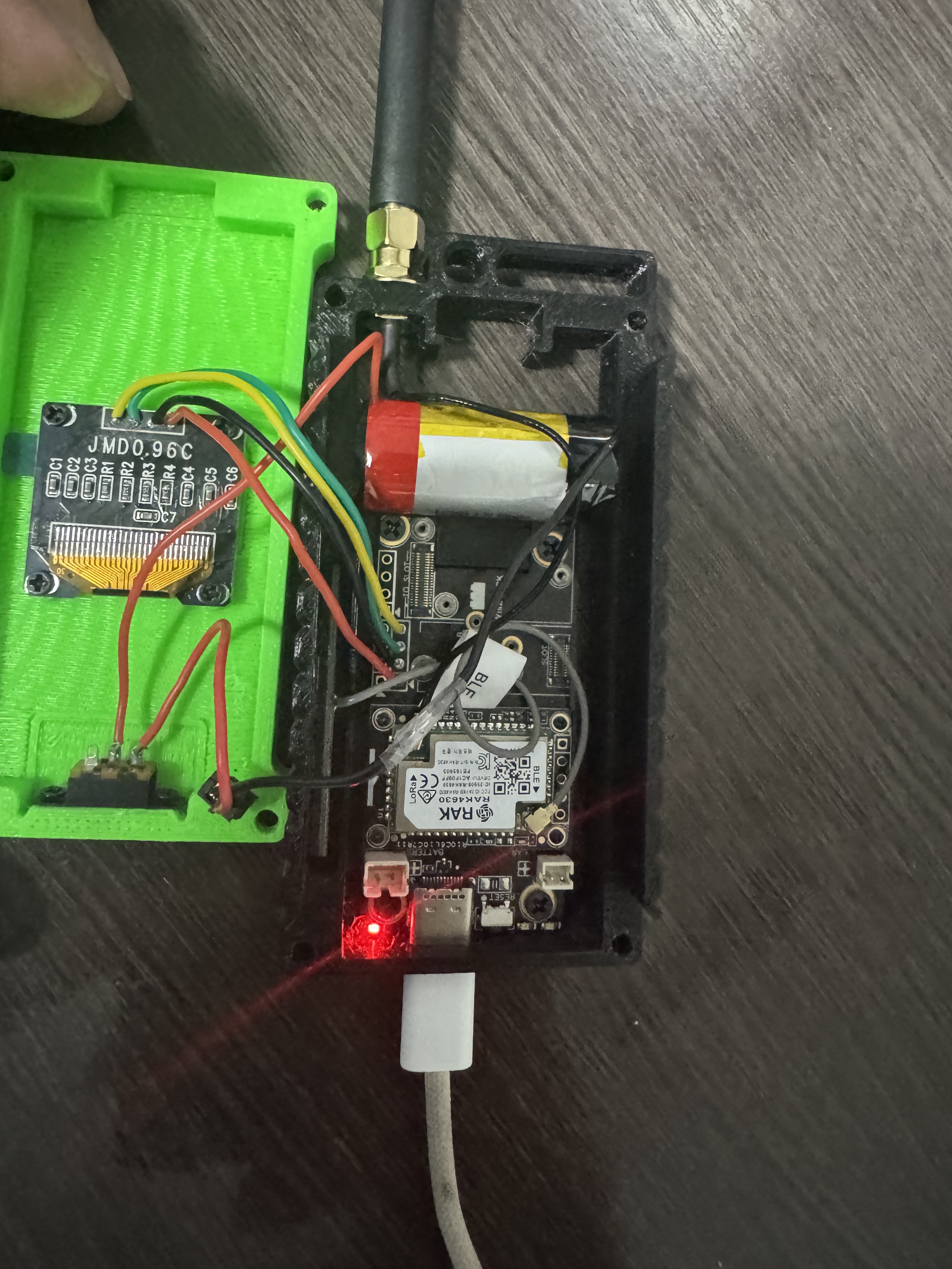

When I plug the usb chord I got one green light flash and another fixed red.
Any suggestions?
Thx

This is a 800 mah battery and they are connected though the battery stj conector straight to the board
It is heating up and won’t starting the device even if I unplug the battery and try to run only by the usb cable.

The part you say is getting hot is a capacitor on the supply voltage for the Core module and the IO/Sensor modules. Could there be a short between the battery cable and the Base Board anywhere?

I’ve disassembled everything and it still getting hot.
I tested without the core and it won’t get hot.

Looks like somehow you fried the Core module.
Do you have another WisBlock Base Board to test the Core module?
