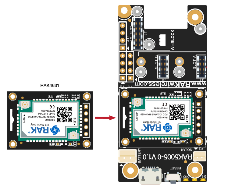

Was it a starter-kit or did you buy the WisBlock Core and the WisBlock Base Board separate?
And no offence, but is the Core module mounted correct on the WisBlock Base Board?
Bought it separately & the module is mounted correctly as shown in the figure
Looks like either the USB connector on the Base Board is defect or the WisBlock Core module has a problem.
Did you buy directly from RAK or from a reseller?
If you bought from RAK store, please send an email to [email protected] and ask for support.
If you bought from a reseller, contact your shop.
