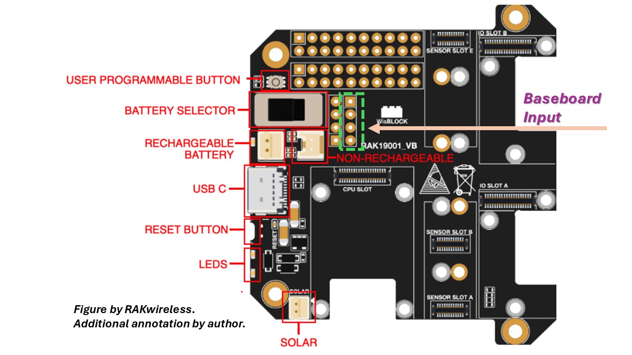

Like Andy, I have a base to which I am trying to connect a RAK1921. My base is RAK19001. The figure in his original question helps but the nomenclature on the RAK19001 is somewhat different. I do not mean to quibble but are these the same:
Vcc ==> Vdd
SCL ==> IC1_SCL
SDA ==> IC1_SDA
Trying to make sure i do not do a smoke job. ![]()
Correct.
If you plug-in the OLED as shown in the pictures, the pin assignment will be correct.
The pictures and nomenclature shown in the thread and the documentation for the OLED do not correspond exactly to the RAK19001. But, your YES to my question does help. I can proceed from there, although it does not appear to plug-in but requires soldering eight very small PCB connections. Since I am not overly keen on the electronics side, things were a bit confusing. Thank you for helping to clarify things for me. (The discussion on stand-offs was also helpful.)

Connected the OLED to the baseboard by soldering the OLED mounting kit’s four-point male-to-female plug to the associated solder points, as shown in this figure:
I did not use the female-to-female plug because the physical rotation required of the RAK1921 relative to the RAK19001 was unworkable. Instead, I soldered four jumper wires to the RAK1921 and plugged the other ends into the associated points on the male points on the female-male plug.
