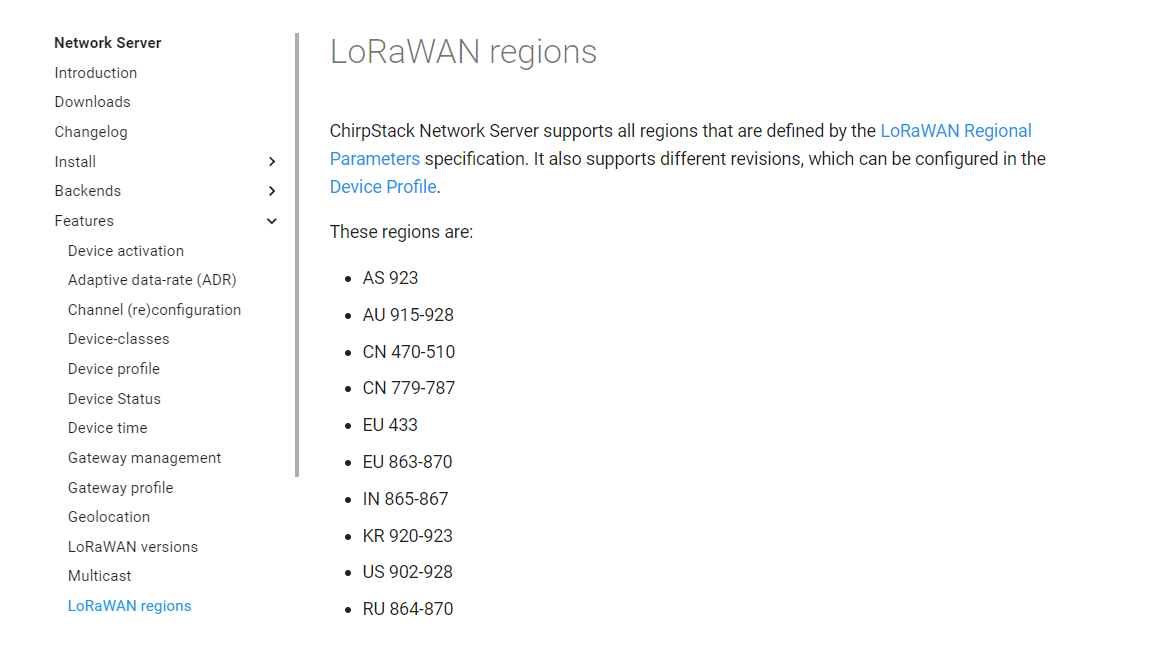

Then I think it is a problem of frequency band selection. The Chirpstack you install is EU868 frequency band, so you need to modify it.
Yeah, I changed AS_923.
