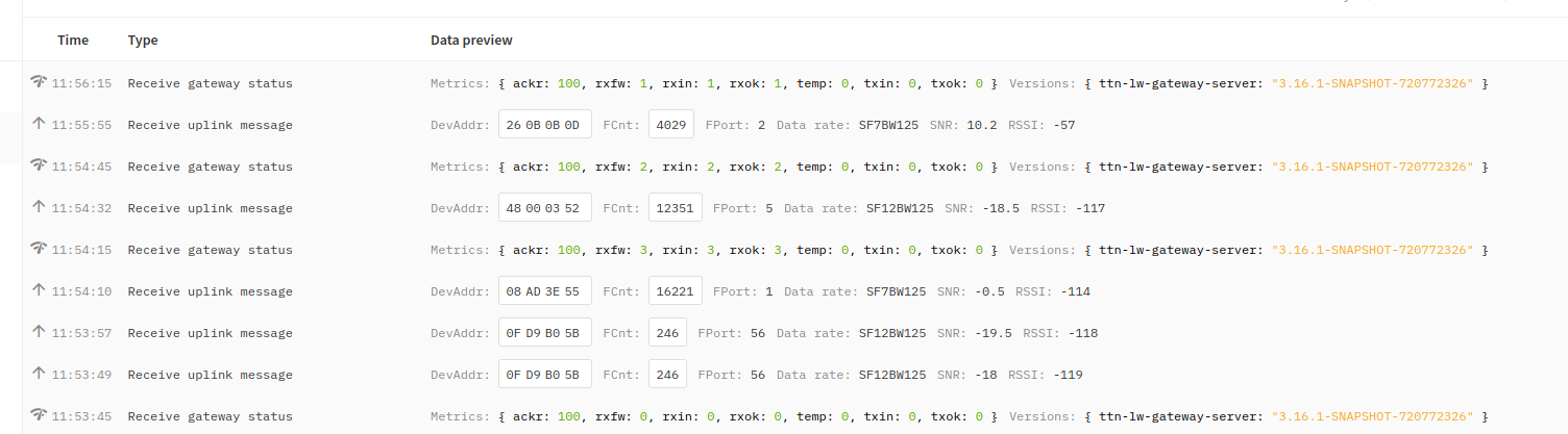

You don’t really need a node to check if gw is working ! You should see the heartbeat sent every 30s by gateway to TTN/TTS and it should also show up as online there !
Side note: for configuring RAK gateway to connect at TTS, you just need to change URL in packet forwarder and restart it, nothing else is needed and same for Helium using Helium URL (and each time for sure declare the gw in console
