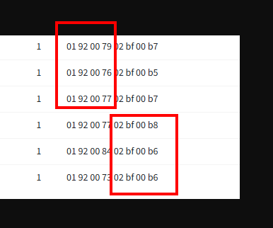

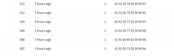

Yes they are both correctly captured and ADR is active. Here is a photo of how the data received looks. I was expecting a 01 and a 02 but I am only able to receive the 01.
Aren’t these the payload?

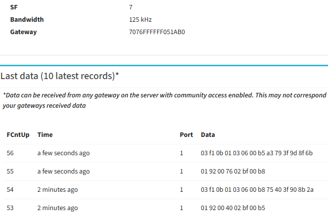

Good observation. Thank you so much for pointing out. Now if I may inquire why is this 01 separate to the 03 and not able to combine even when the SF is down to 7?
This is a known limitation with the current Bridge IO firmware. The next release is optimized and will squeeze the number of polled payload on what’s allowed on the SF being used.
