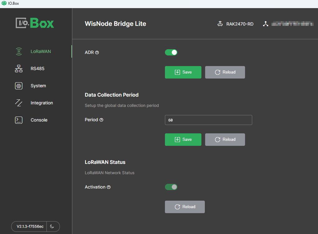

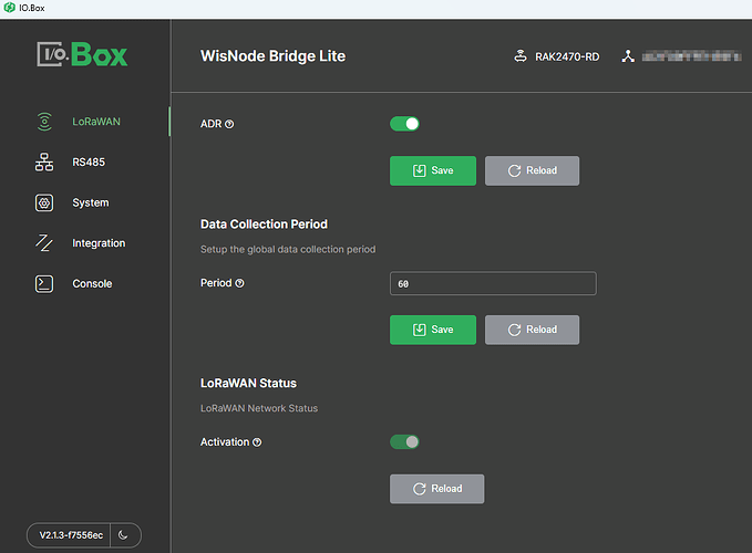

Sure thing, apologies for the lack of information. Was initially using an old version, now on V2.1.3-f7556ec.
Lorawan settings are all good, and I have Data Collection Period set to 60 (sec?)

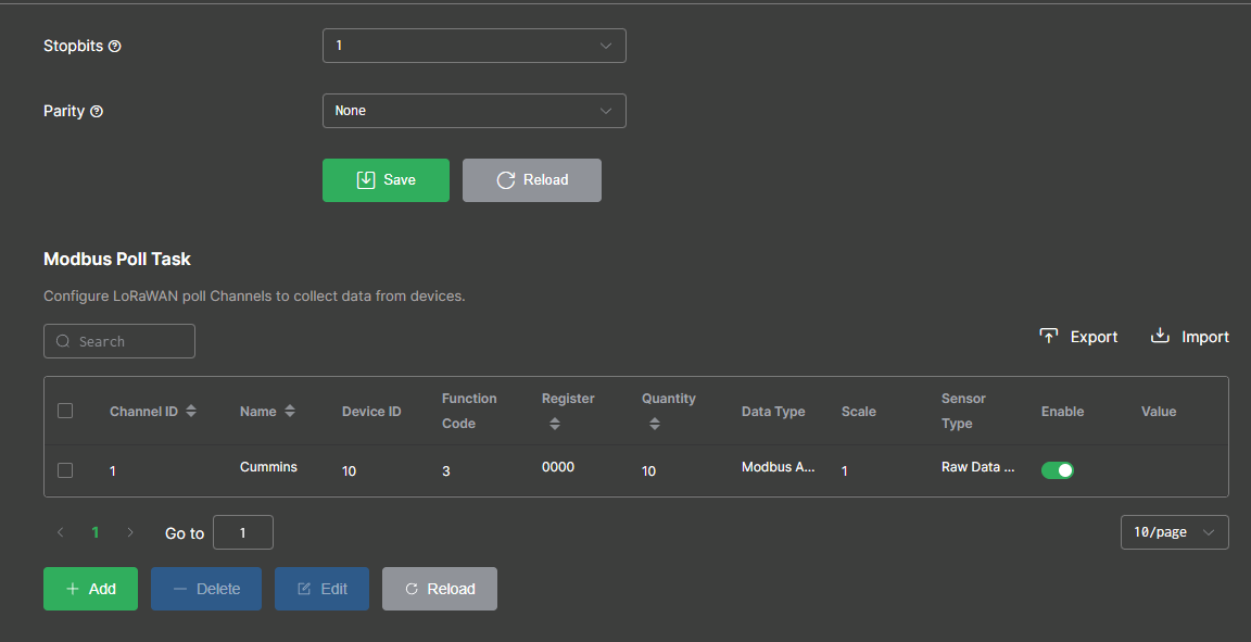

I have configured the RS485. I’m confident in the Poll Task as the Read Request matches the one previously on the motor connected with a RAK 7431.

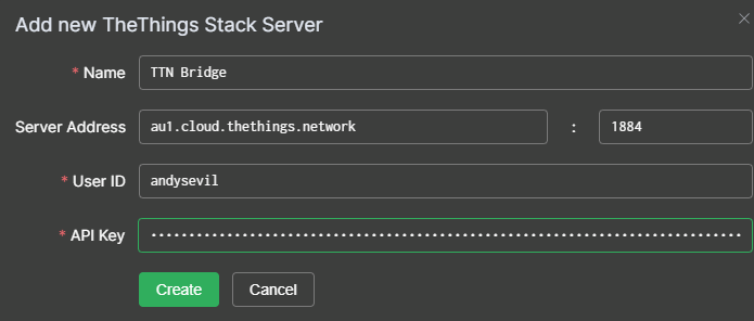

Using the following settings to connect to TTN
And get the following error…
