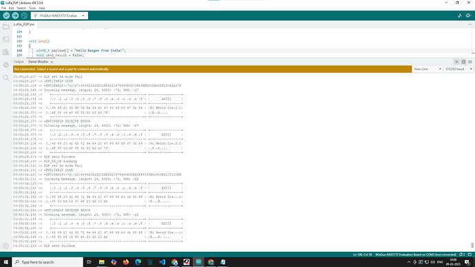

Ohhh! sorry previous byte length i added by mistakenly, but the logs are 25 bytes.
but still why it is not receiving the all the payload data?
and the response is coming only for the 2 -3 mins later it stops the receiving the data.

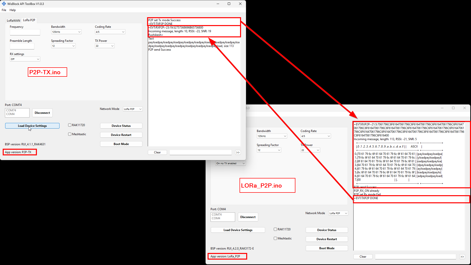

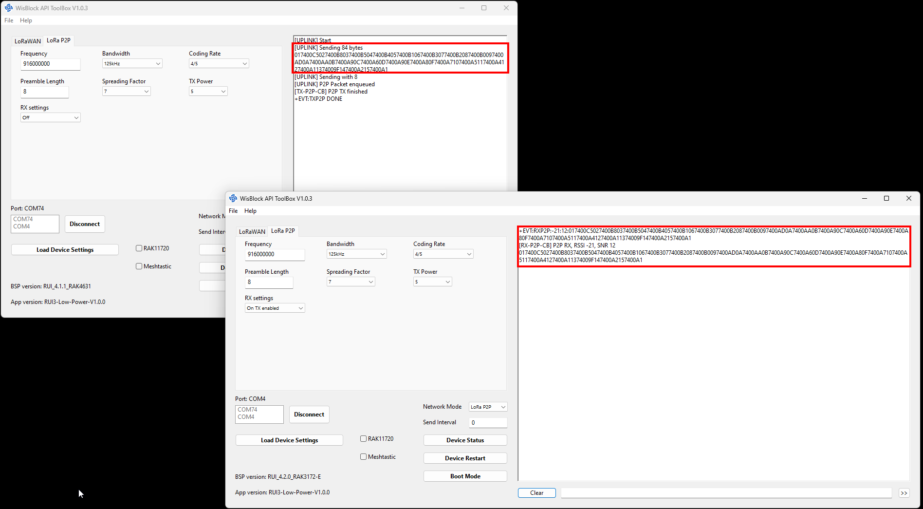

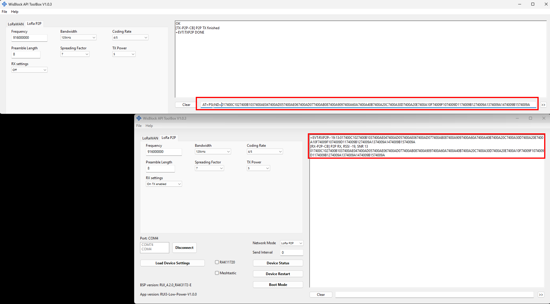

I can send and receive large packets without problems. Here it is 84 bytes.
Same if I send AT commands:
P2P-TX.ino (3.2 KB)
LoRa_P2P.ino (4.3 KB)
i am using P2P-TX file as transmitter program and LoRa_P2P as receiver
can you please check what is wrong in that?

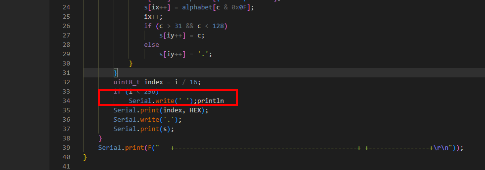

Your LoRa_P2P.ino code doesn’t compile. There is a stray println in it:
After removing that, it works when I send 84 bytes of data from my own code:

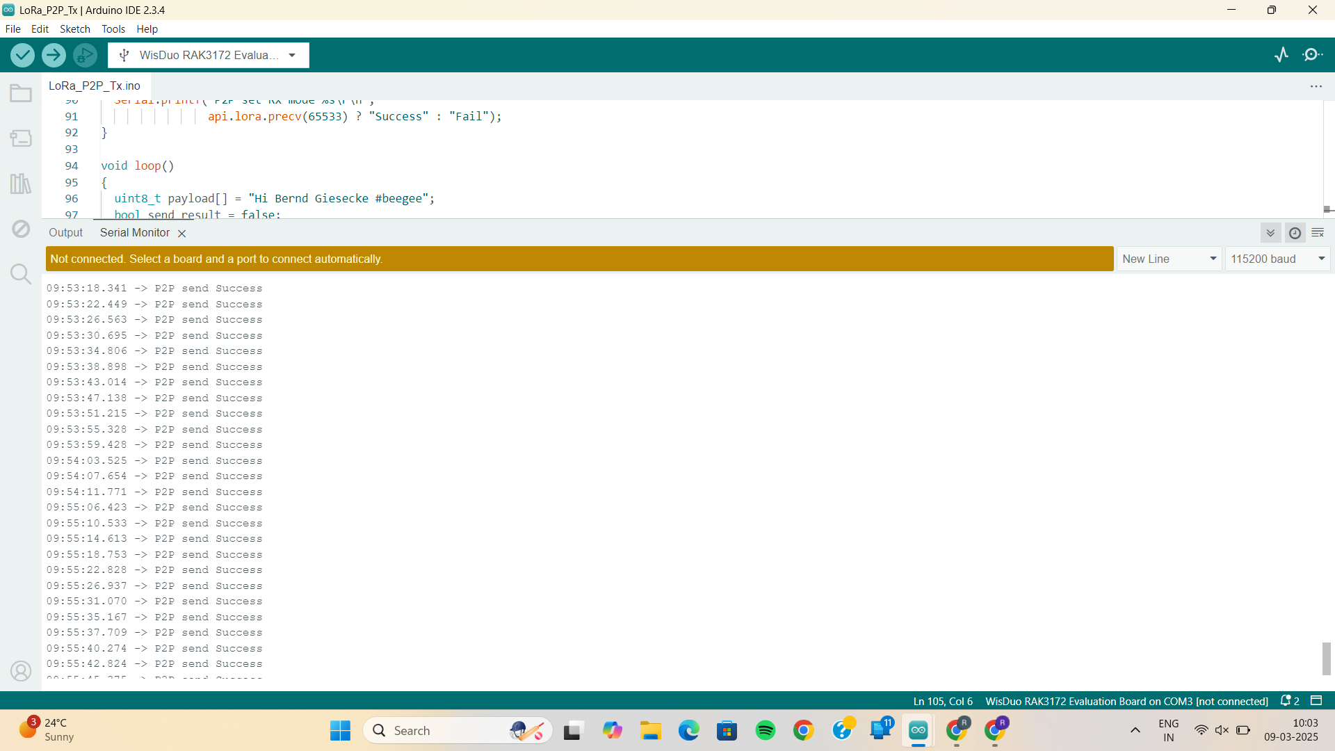

For LoRa-TX.ino, it works, but I don’t understand why you switch to RX mode in the send callback. You never get the response from LoRa_P2P.ino
Fixing that with
void send_cb(void)
//   Serial.printf("P2P set Tx mode %s\r\n",
//                 api.lora.precv(0) ? "Success" : "Fail");
				api.lora.precv(65534) ? "Success" : "Fail");
And changing the payload to a much longer one, it works as well and it receives the response value:

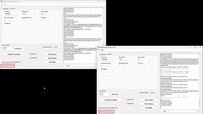

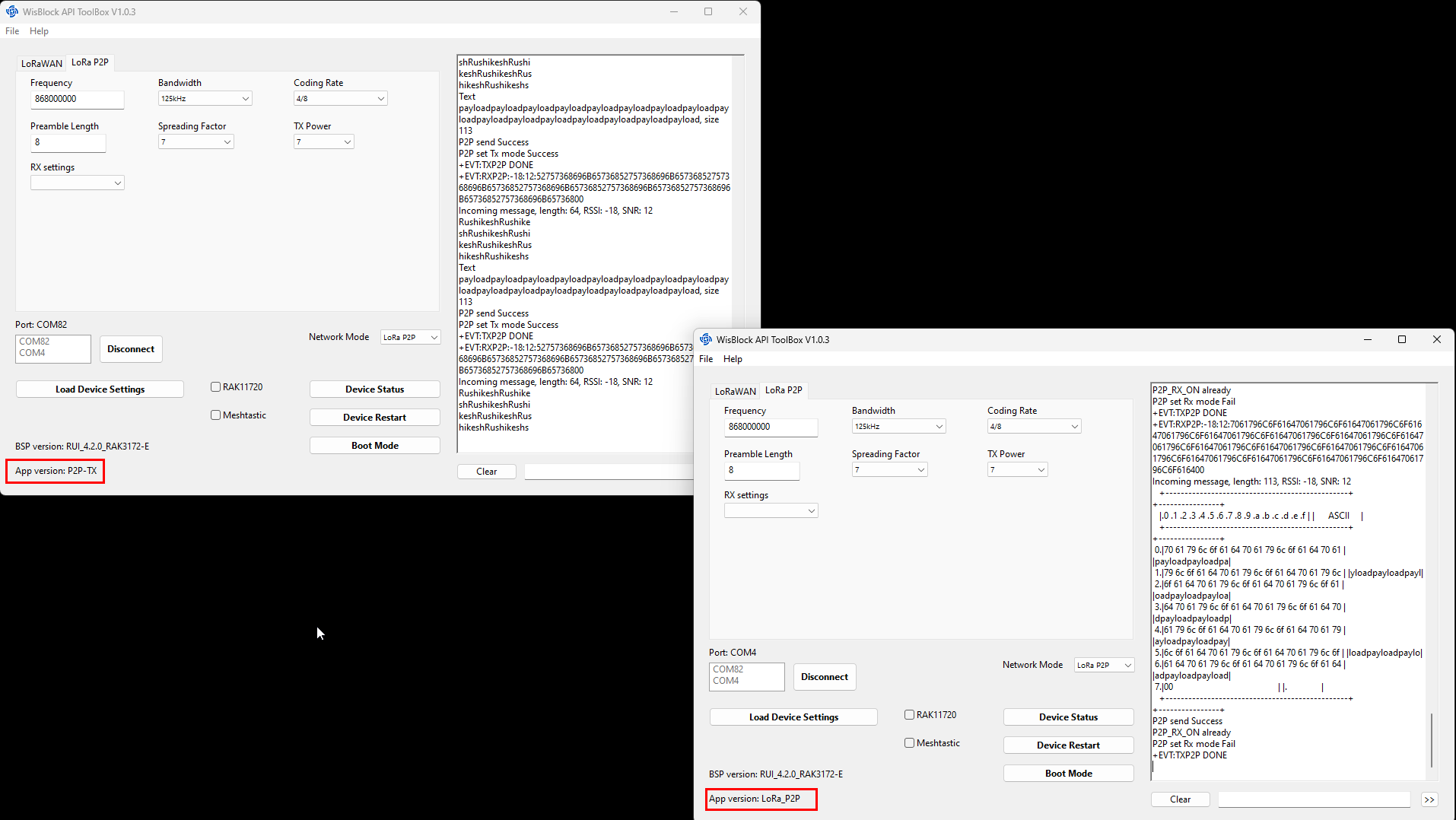

Hello Bernd Giesecke,
below the code file that i have changed, please check this out
P2P-TX.ino (3.2 KB)

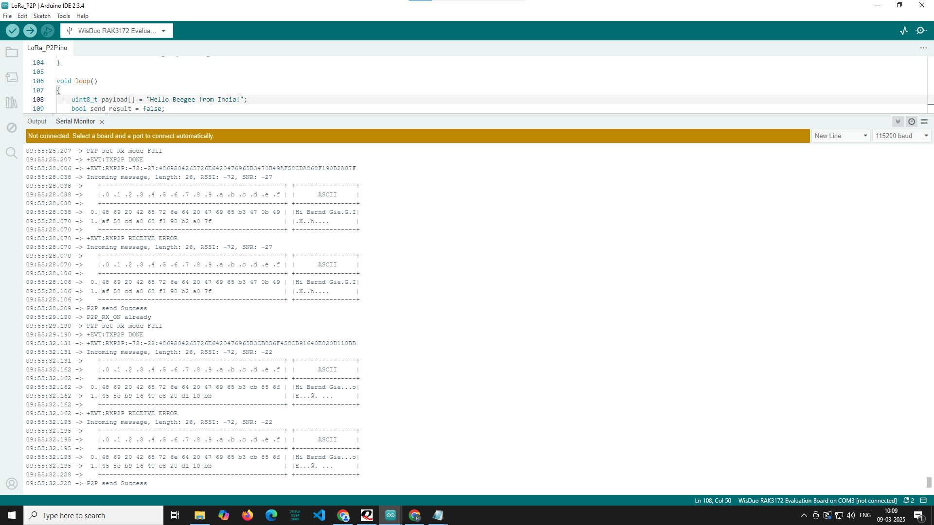

and the response for the both code is as below,
this is Tx code response
this is P2P code response

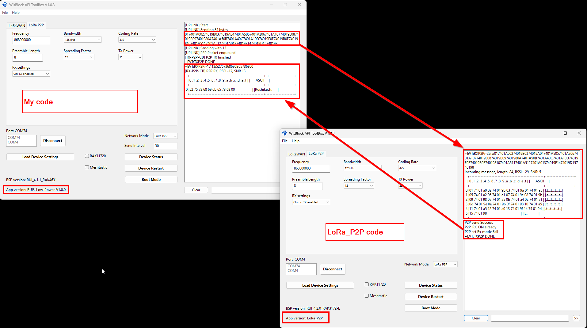

For now, I have removed the board to take steady screenshots and to make any further changes I need to, as it is still not sending more than a 12-byte payload. There seems to be a significant difference between your response and mine, and I’m not sure why.
Latest RUI3 version is 4.2.0, try to update your modules.
I don’t need to check your code, I already tested and it works.
Thank you for confirming your code’s functionality. It’s helpful to know it works in your testing. However, I’m using RUI3 version 4.2.0, and there seems to be a discrepancy as I’m still facing the problem.
Therefore, I’ll be adapting the code to address the issue within my specific environment. I appreciate your assistance.
