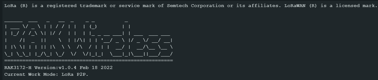

Using Arduino IDE to download. While making mods in code, I ended up having the issue “detecting baud rate” and then it does not download.
I downloaded the firmware available in downloads section using STM32Cube Programmer (with the intention of reset everything).
I was successfully able to download it / reflash it.
But still can’t download “any” code from Arduino IDE.
Any other way to do a hard reset?
When I connect my board to serial output in Arduino IDE, and press reset, I get the above output.
Appreciate the help in bring it back to life if we can. Controller is bricked?

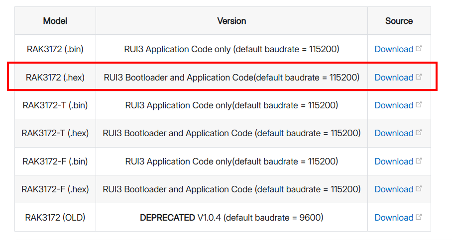

Hi @omerattiqahmed ,
You are using a non-compatible RUI3 FW.
Reupload again using STM32CubeProgrammer with this FW.
