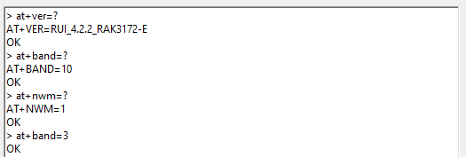

Make sure the device didn’t try to join the network with AT+JOIN=0:0, then restart and try again.
Update to RUI3 V4.2.2 ==> RAK3172 WisDuo LoRaWAN Module Datasheet | Specs & Features

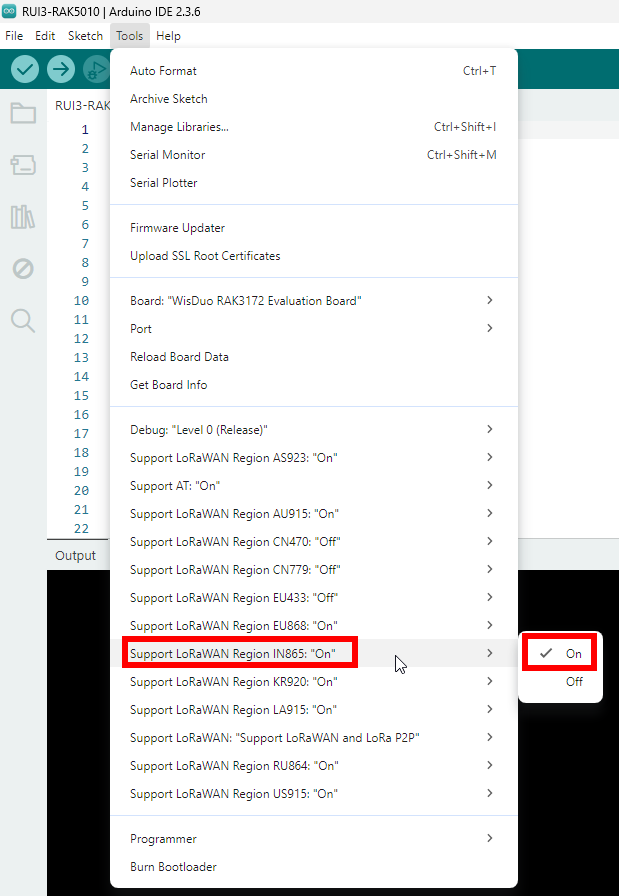

Another thing, are you using the default AT command firmware or are you using a custom firmware built with the RUI3 API?
If it is a custom firmware, please make sure you have enabled IN865 when you compile the firmware.
