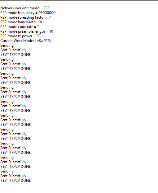

Why do you use api.system.restoreDefault();?
It is not necessary to restore system defaults on every reboot. It is only needed if something is messed up with the settings.
Removing that line and it works.
Thank you. It is working now.
