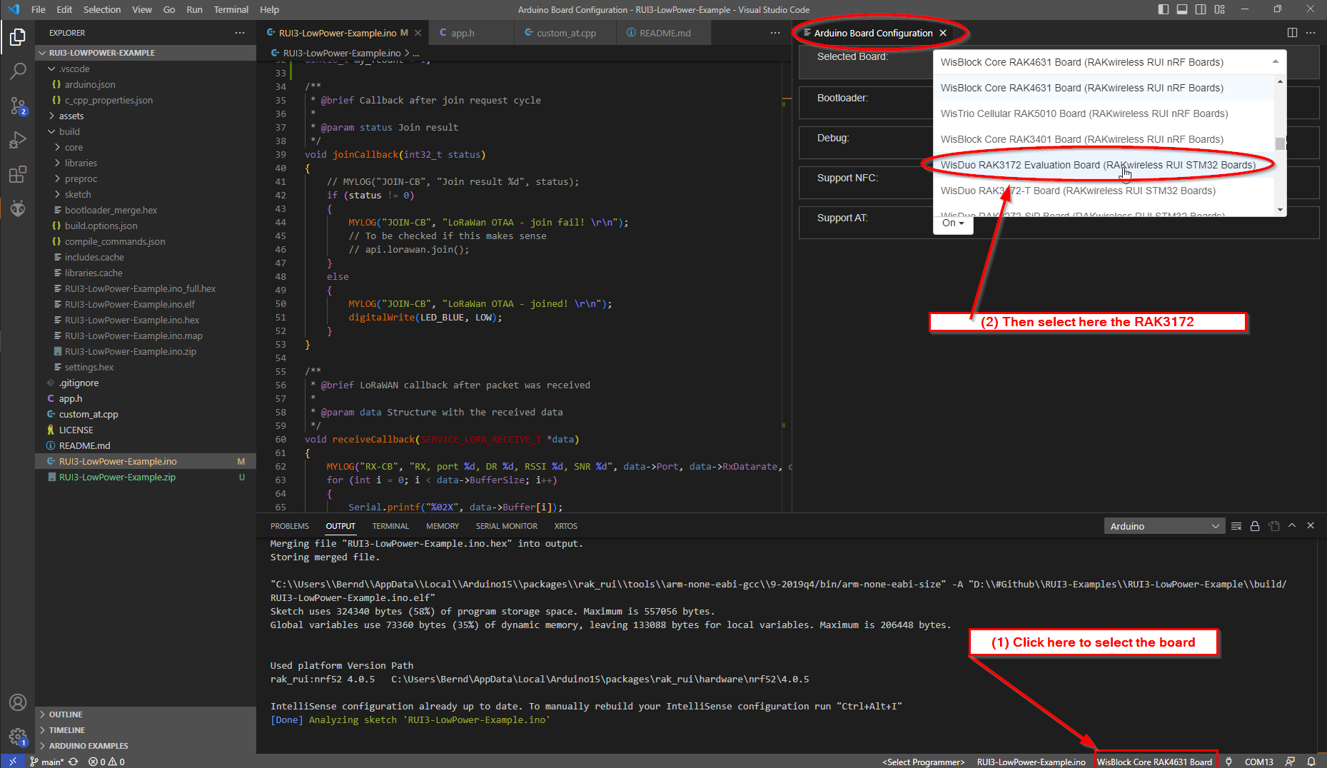

Did you select the RAK3172 RUI3 board?

Hi @beegee, thanks for the prompt answer. Actually I have selected the board, but I didn’t have the file initialized because I was using a .cpp file instead of an .ino one. Anyway I’m not able to make the extension work since I have another error about python3 not finding a buildtime.py file when it tries to verify the sketch, but in this case I suppose it is something related to my system or the extension itself.
Yes, you need to have one .INO file for the thing to work.
I am wondering why it looks for buildtime.py. On Windows the required file is not a python script. It is an EXE file and installed with the BSP.
Are you on Linux or MacOS?
I’m on MacOS. But your screenshot just helped me: I had not that file on the specular path on Mac, so I suppose I had the board installation broken somehow. I have uninstalled the board and re-installed again and everything works now
