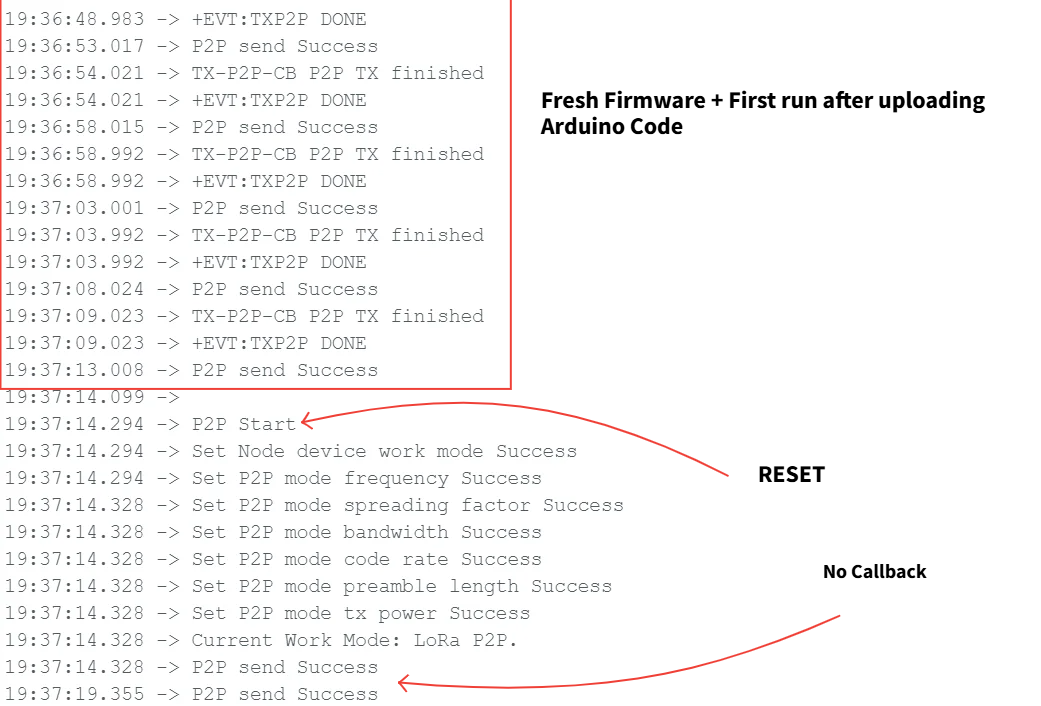

Apologies for the confusion. I’ll try explain the issue more clearly. Using psend like in the example code given in psend(). - Serial.printf(“P2P send %s\r\n”, api.lora.psend(sizeof(payload), payload)? “Success” : “Fail”);
I get the “P2P Send Success” message but no “+EVT:TXP2P DONE”.
I have observed that without the “+EVT:TXP2P DONE” message, the packet does not actually send.
I have been able to get the “+EVT:TXP2P DONE” on any of my codes immediately after using STM32CubeIDE to do a clean install of the firmware and then uploading my code. But any subsequent code uploads / or resets (including the same code that just worked) will result in the same issue of getting the “P2P Send Success” message but no “+EVT:TXP2P DONE”.
It seems like the board is getting into a stuck state that at the moment, I can only fix by doing a clean firmware install.
Is there a way to force the board to print either “+EVT:TXP2P DONE” or “+EVT:TXP2P TIMEOUT”?
Thanks
The +EVT..... messages are asynchronous messages, you cannot force them to appear.
Did you implement the P2P TX callback that the RUI3 API provides? See an example here ==> LoRa_P2P_TX
Did you enable CAD at any time with AT+CAD=1 or enabled it in the API TX call with the third parameter api.lora.psend(4, g_solution_data, true)
yes, I did implement the TX callback but it never triggers. Also have never enabled CAD, I just ran a test where it was explicitly disabled and no different. I’ve uploaded a screenshot of what I’m seeing + the code I am running.

I got it. I was using the RAK3172 Evaluation Board in Arduino IDE to upload my code. Using the correct board has unsurprisingly fixed the issue.
Thanks.
