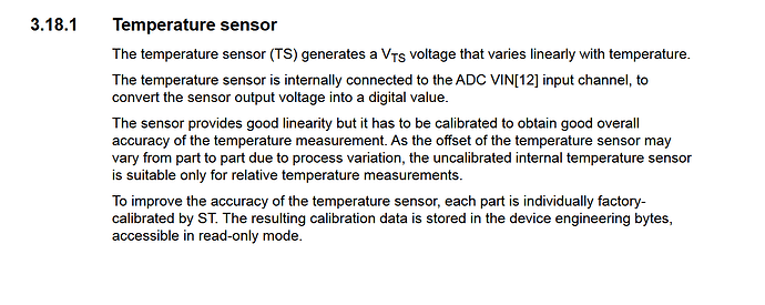

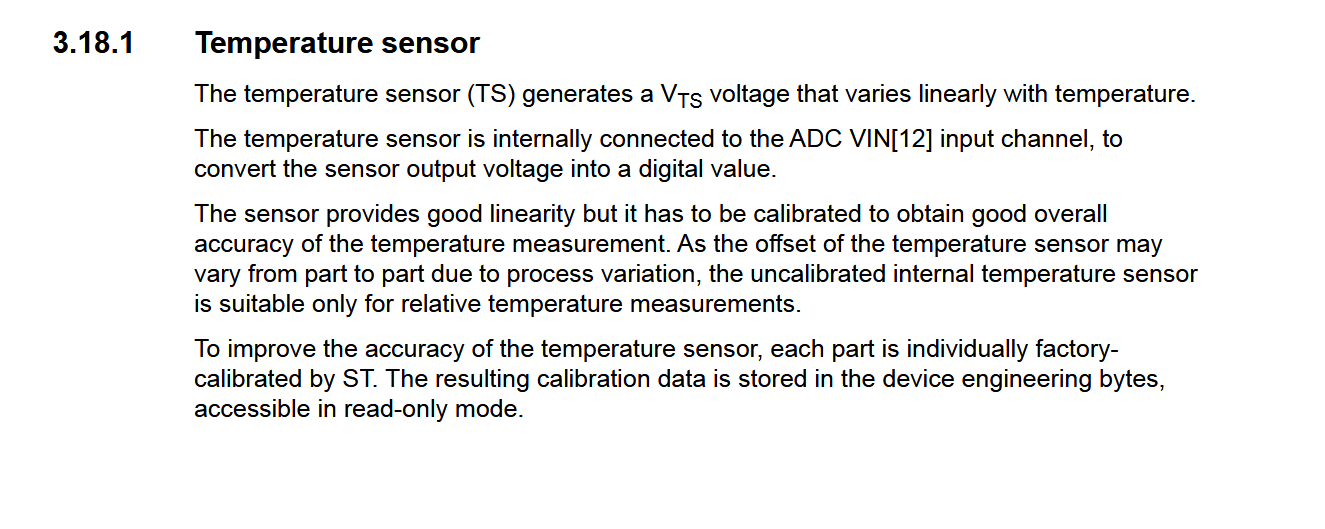

  1. There is an onboard Temperature sensor on ADC channel 12. Is there any way of accessing that through the RUI?

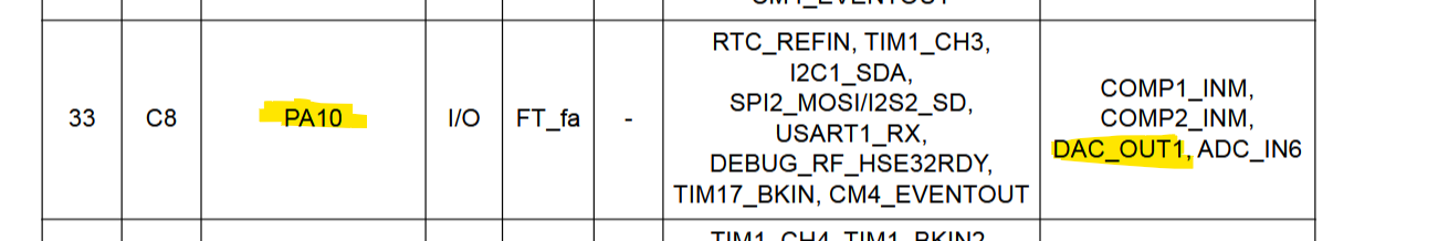

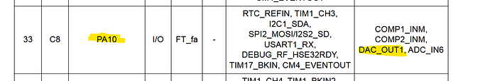

  1. Theres also a DAC on PA10. I couldnt find any mentions of a DAC in the 3172 datasheet. Could I just set up PA10 as analog out through the RUI?

RUI3 doesn’t have functions for the internal temperature sensor and the DAC output.
You can check in the uhal/udrv functions in the RAK3172 BSP, but on a quick check I didn’t find anything related to that.
AnalogWrite in RUI3 is a PWM output, not a “real” analog voltage.
