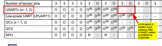

Hi @Giovanni ,
I am not sure what PM is (Power Management?). But if this is in STOP MODE 2, it will not be able to wake up your device on USART1.
STOP MODE 2 only allows LPUART1 which is mapped to USART2 in STM32WL.
Here’s screenshot from datasheet.
You can refer on Low-power Mode section of the STM32WL datasheet for the difference of STOP MODE 0/1 and STOP MODE 2.
