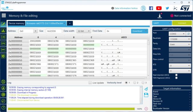

I had some problems to flash it. Only option I found was a chip-erase and flashing with STM32CubeProgrammer.

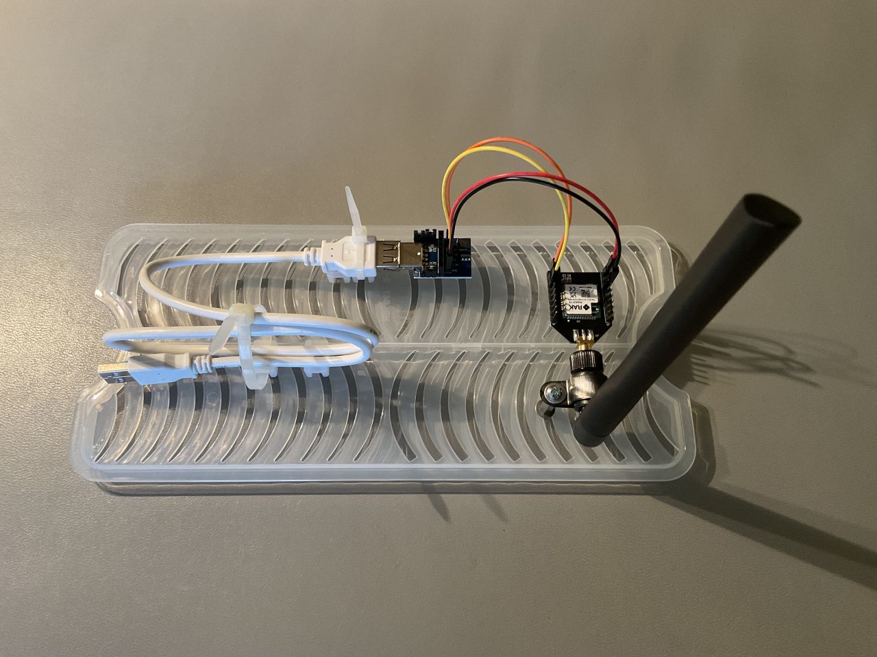

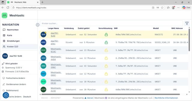

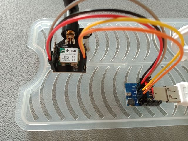

Just a quick update:
I flashed the FW firmware rak3172-2.6.11.60ec05e.bin using the STM32CubeProgrammer and the Boot0 PIN.
During a quick test, I was able to exchange text messages.

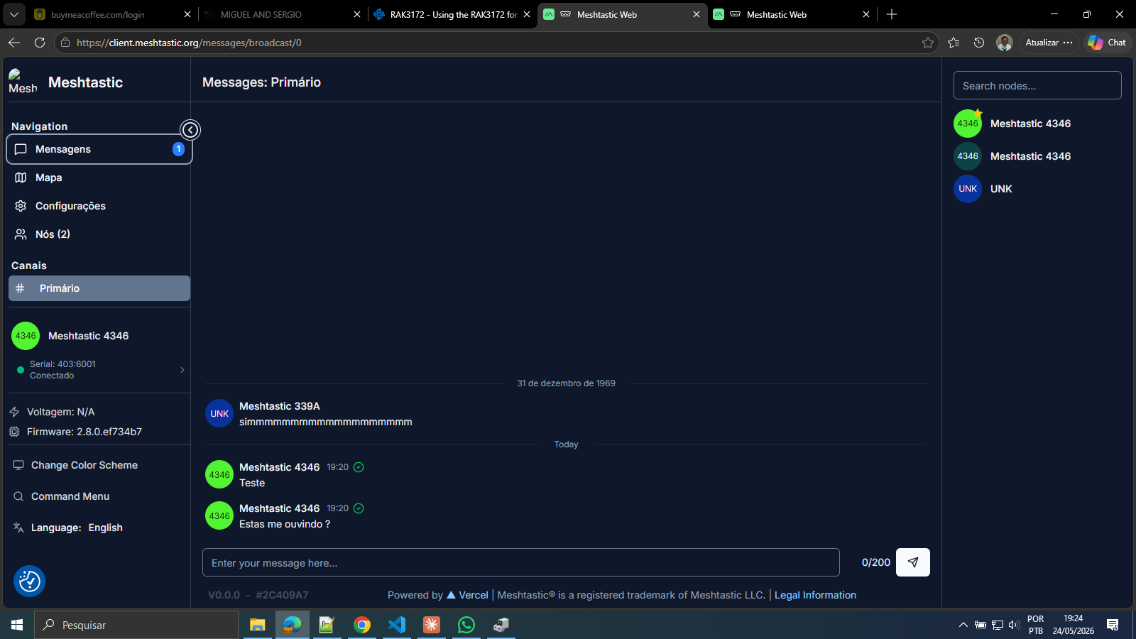

Hi, I have a product with RAK3172 is them. I was hoping to use Meshtastic to create a local network between them. Is there any more information on this?
What are the limitations on the RAK3172 with Meshtastic?
Any further developments/support?
Is is something I can feasibly progress with, or are there real reasons/limits/incompatibilities that would block me?
