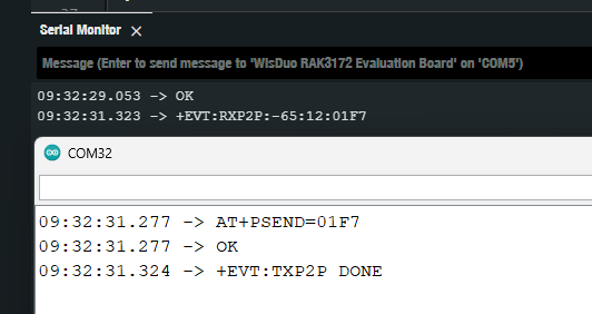

Wow, thanks again for the swift response! With this change will i need to format as AT+PSEND= and then parse the result or can i just send two byte hex values and receive them on the other end? Example values i need to send are 01 F7. I apologize for my ignorance, i’m just most familiar with digi radios where I can send HEX or ASCII, which is what I understand this package is to somewhat emulate.
Hi @Mickeyba ,
You will receive it as is.
is that 01F7 hex or ascii?
This payload is Hex.
