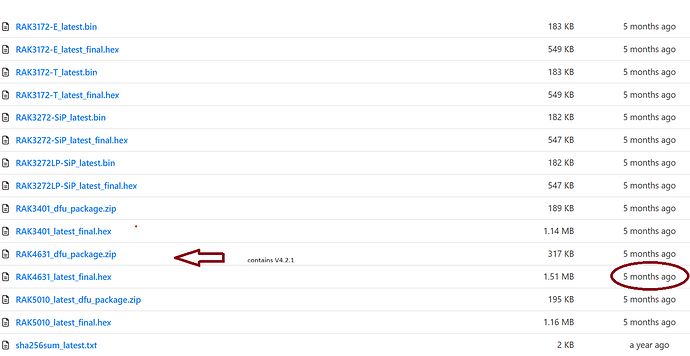

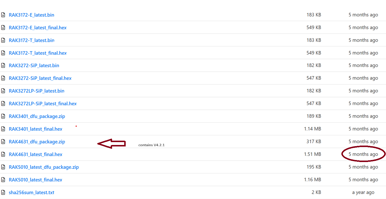

I’ve used Wistoolbox and dfu in the past. The dfu image below contains V4.2.1 and I see RAK4631_latest_final.hex was updated 5 months ago…which seems very old ?
Sorry, seems Download Center is late in updating.
Download RUI_4.2.2_354_release_firmware.zip.
All 4.2.2 files are inside.
