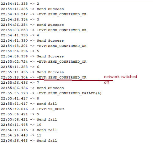

I switched OFF the LORA Gateway just before message 7 was send out…yet at 22:55:26.436 I get “send success”…even the RUI stack printed +EVT:SEND_CONFIRMED_FAILED(4)…but api.lorawan.send() returned all good.
Subsequent messages shows “Send Fail”, which is correct. I find it that the very first message that is suppose to be lost shows as “Send Success”
What is the best practice to make sure I check for successful delivery?
