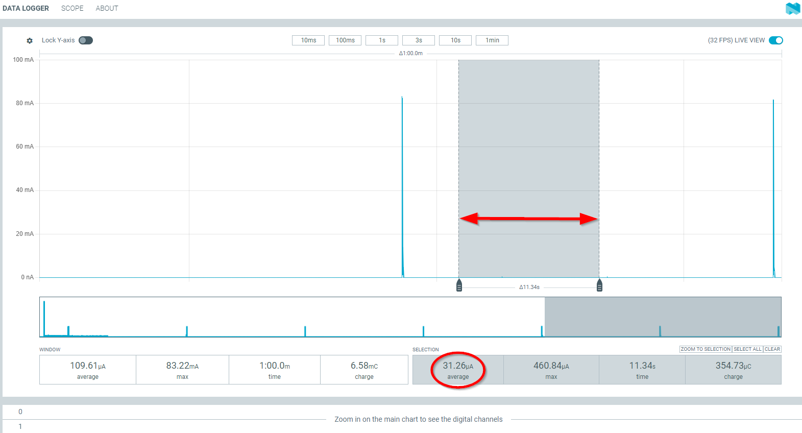

Just a work around, not a bug fix yet.
After you called api.lora.psend() add the following lines to your code.
	delay(50); // sleep time depends on packet TX time and needs adjustment.
	api.ble.advertise.start(1);
	delay(50);
	api.ble.advertise.stop();
R&D is still looking for the underlying problem.
Result from attached test application. Measured with WisBlock RAK4631, so sleep current are higher than from a custom PCB.
RAK4630-P2P-Low-Power-Test.ino (4.9 KB)
