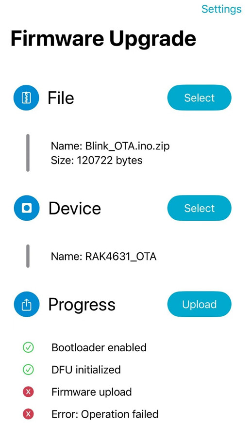

Hello, I am using the core of RAK4630 and using the sample code ble_ota_dfu (without making any modifications). The tested mobile phone is iPhone 16 and the software is DFU. After burning the ble_ota_dfu code onto RAK4630, the blue LED flashes. By using the DFU software to perform Bluetooth OTA on RAK4630, the DFU software page shows an error as shown in the figure. The blue LED goes out and the green LED has a breathing light effect.

Yes, every time the firmware update via Bluetooth OTA fails, one must use USB to reflash the ble_ota_dfu code. But my problem is that every time the firmware update via Bluetooth OTA fails at the same location.

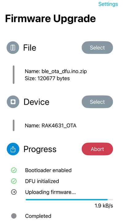

After modifying the PRN, OTA can be carried out. However, the OTA (Over-the-Air) speed is relatively slow.
