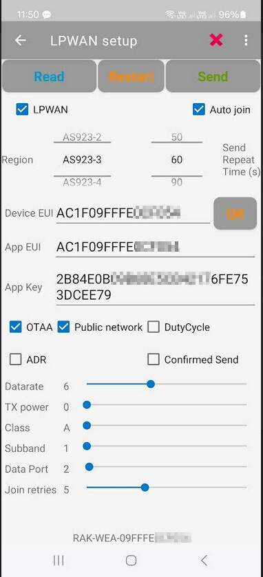

- Might still be working with an Android app WisBlock Tool Box for LoRaWAN settings as well, but that might be broken now as I could not keep up with new Android versions coming out.
Still working on my old Android phone:

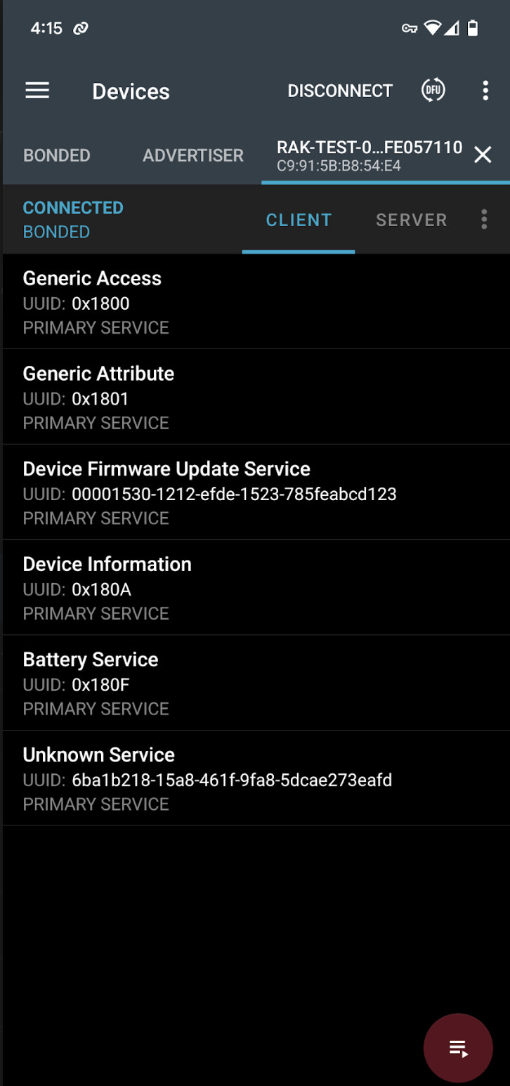

Wow thank you so much. This compiles and runs on my rak4631 however I get the same problem as before. The serialUART doesn’t seem to be recognized by any of my ble serial apps. NRF toolbox uart mode : “Device was disconnected, because required services are missing.”
Adafruit Bluefruit : no uart service detected
NRF Connect shows all the DFU service, Batter Service, etc and Unknown service ending in EAFD (no UART service)

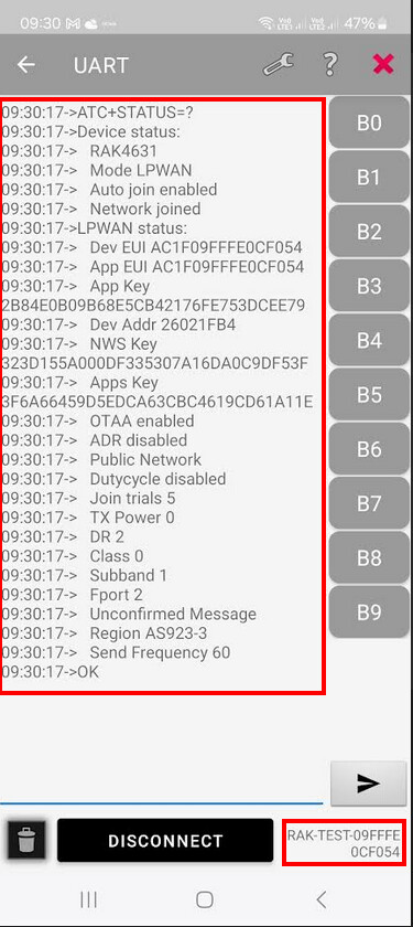

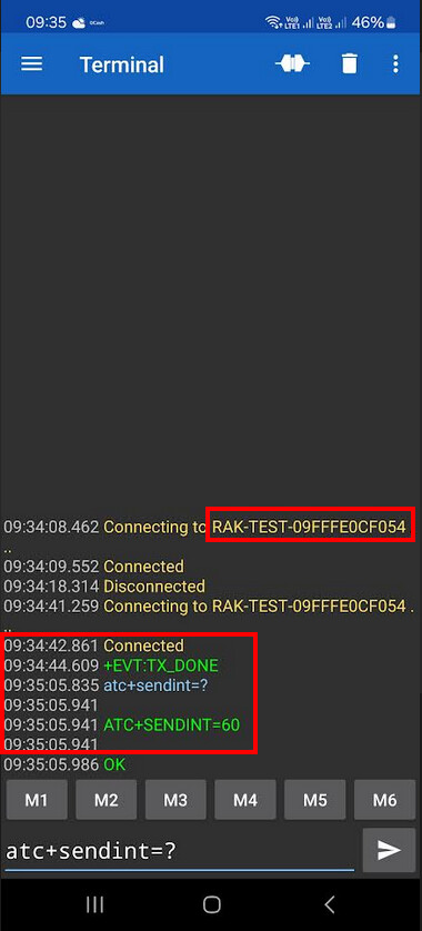

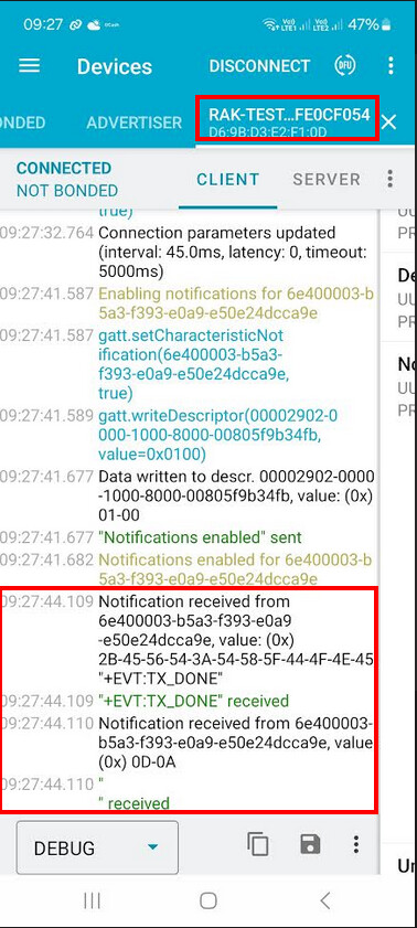

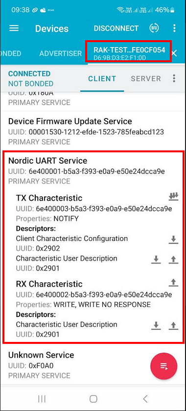

That’s weird.
I don’t have nRF Toolbox installed, but I can connect without problems with
nRF Connect shows as well the correct characteristics
No idea why the characteristic is not showing up on your device.

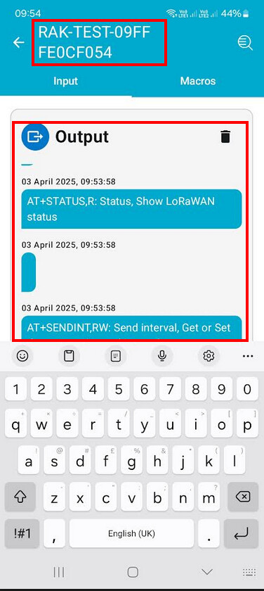

Quick test with nRF Toolbox, works as well.
So it is either your phone or something happened during compilation.

With your uf2 I get the same problem. The last service uid ends in EAFD again and no service ending in CA9E like yours. This board started out as a Meshtastic starter kit. Could the hardware somehow be different and not create the proper uid’s . I would think that would be in the software.
