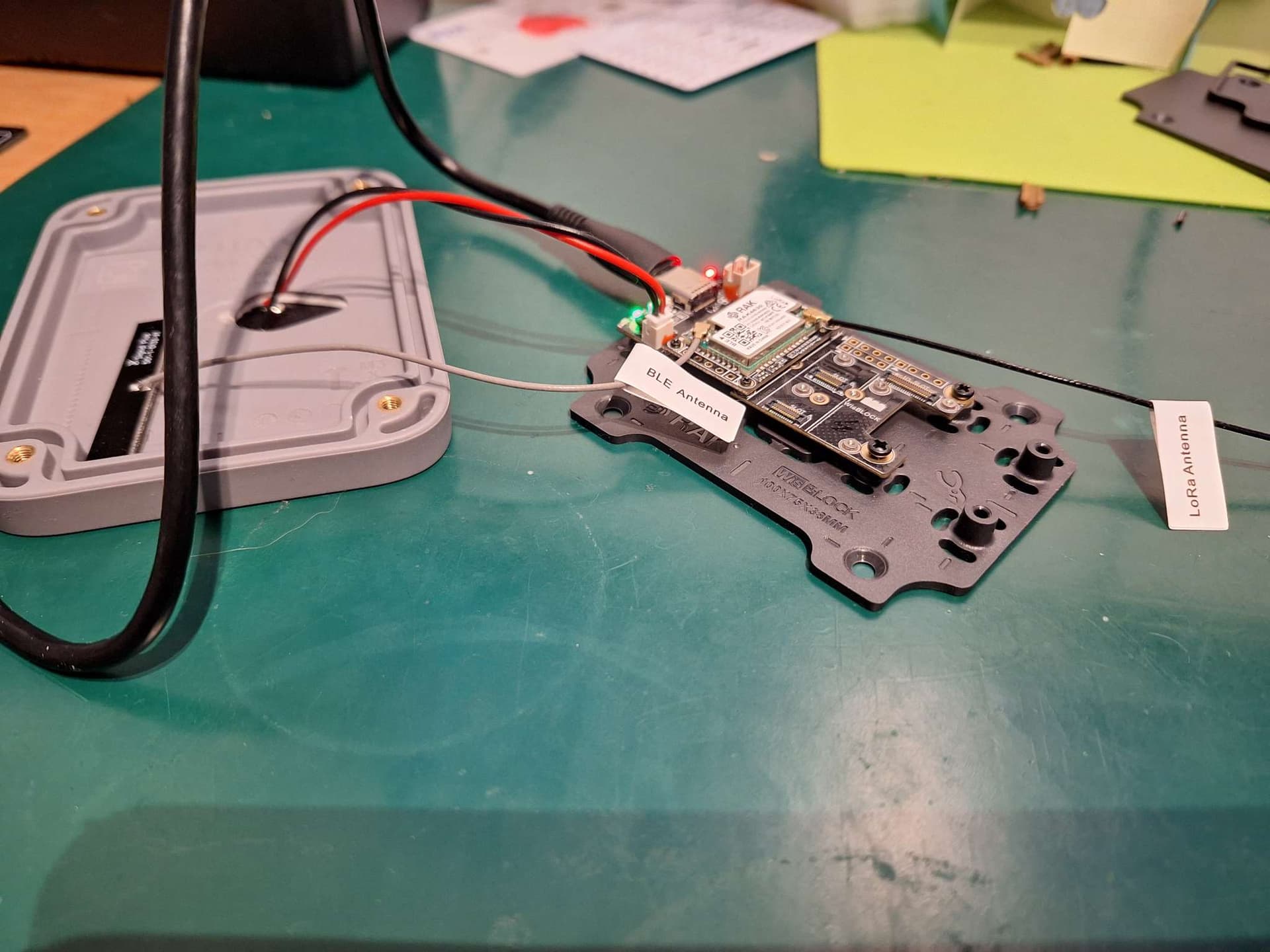

There is a very weak signal in my house. I went up three floors up and saw other nodes.
But, screwing the enclosure together is an ancient tragedy. I mean Unify Enclosure Solar IP65 100x75x38mm. The holes are very deep and the screws are very small and not magnetised.
Glad you found some Meshtastic nodes.
For the enclosure, I was complaining the same to our mechanic engineer. He said “get the matching screwdriver, it will hold the screws” :rofl:
After 3 years using these enclosures, I got used to it and know the tricks how to get the screws in.
@beegee
So, share this knowledge with us. :slight_smile:
I will have to make a video :rofl:
Just hold the screw to the tip of the screw driver, push against the wall of the opening where the screw goes in.
Continue pushing against the wall while you insert the screw.
Once your reached the bottom, wiggle it a little bit, so that the screw goes into the hole.
Fix it.
