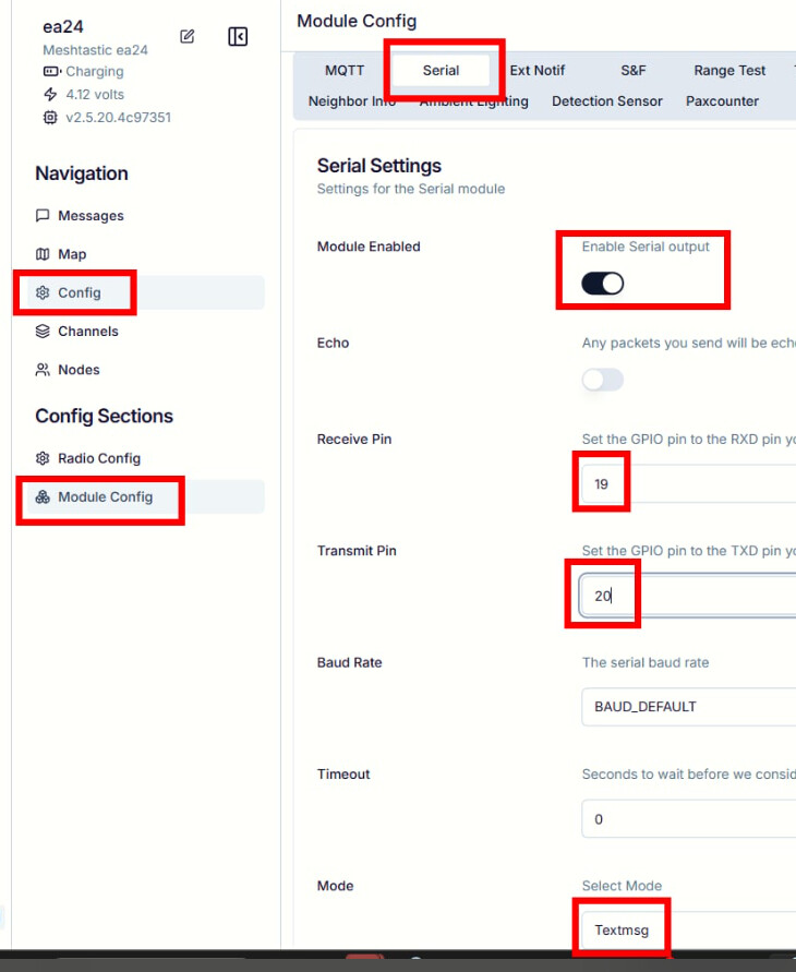

On the non-communicating 19003, I enabled Serial, forced baud rate to 38400 (same on the client side). I have the option to specify RX and TX pin, but what are the exact pin for Serial RX and TX?
If you have RAK19003 ver D or ver E boards, then you must use pin 19 and 20.
You can use setup to see messages via UART.
