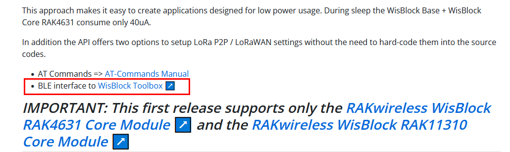

About WisToolBox, that is only working with RUI3 devices. It is not compatible with my WisBlock-API. But I have my own WisBlock Toolbox (confusing with the names, I know, but WisBlock Toolbox is actually longer available than the RUI3 WisToolBox). => https://play.google.com/store/apps/details?id=tk.giesecke.wisblock_toolbox
My Toolbox includes LoRa/LoRaWAN setup, device firmware update over BLE and an BLE Serial Terminal that works with WisBlock-API
Just for completeness, and by coincidence, it looks like the comment that i referred to relating to API credentials was in the article that you wrote for the WIS Block API and Platform IO below:)
