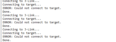

If you can’t connect through JLink, the device is damaged

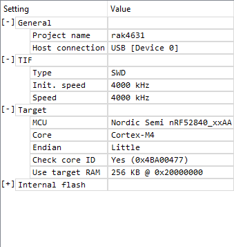

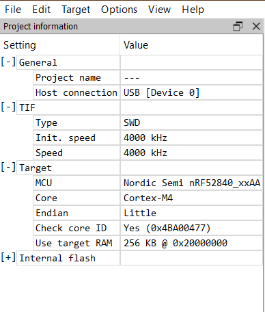

What are your settings in JLink?
I never experienced a device that didn’t connect to JLink unless it was really bad damaged (e.g. by overvoltage)

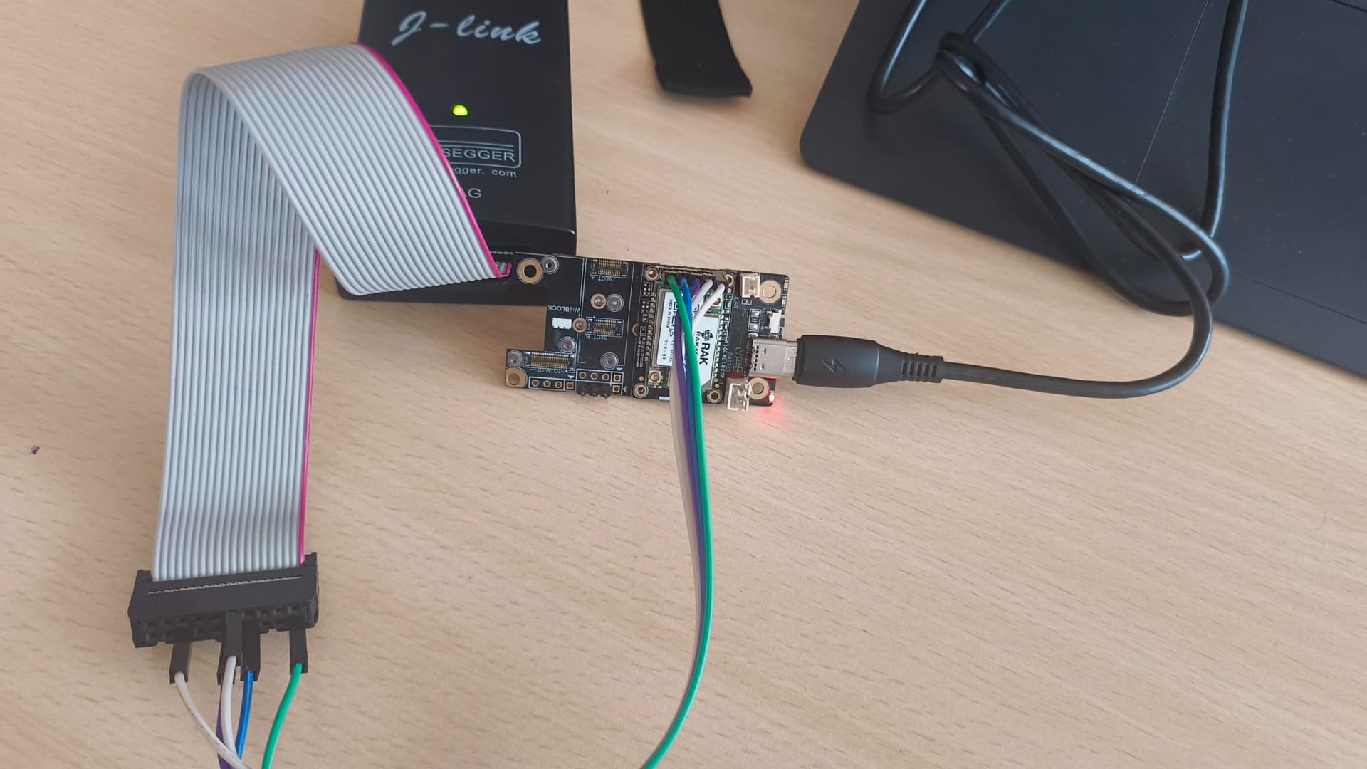

Did you double check your connections between JLink and the device?
I have very bad experience with jumper cables and bad connections.
I have checked connections between JLink and the device and changed multiple jumpers but no use.
This is setting in JLink.
