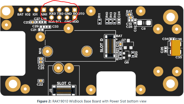

Also, after some investigation I found that the RAK19010 base board mentions UART0 on the J10 header (see image below).
The documentation for the J10 header, however, make mention of UART 1. I assume that the J10 should be UART1, is this correct?
Any help on this would be appreciated.
