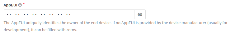

Well, TTI disagrees with that. See their comment:
So unless RAK provides an AppEUI they tell one to use 00.

Also, ChirpStack recommends using 00’s:
Nothings is saying you have to use a value of all zero’s only that the server software will accept such a value.
But it’s terribly bad advice; that number is meant to uniquely identify a particular Application. Set it to something long and at least somewhat random, not all zero’s.
