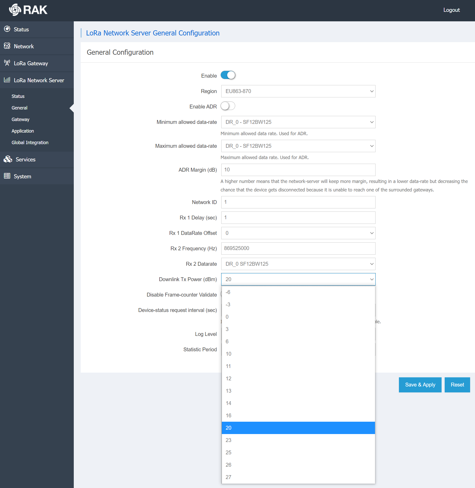

Can the tx output power be configured in the gateway or in lora network server?
Hei @cwrx777,
Yes the TX power can be configured in the Builtin server.
LoRa Network Server -> General:

Hei @DarrenW ,
The Network Server is what determines the power output basically, the Gateway does not decide this on its own, thus the option is there in the Built-in Server and not in the other modes. Whatever Network Server you are using for the LoRaWAN you need to set this there.
