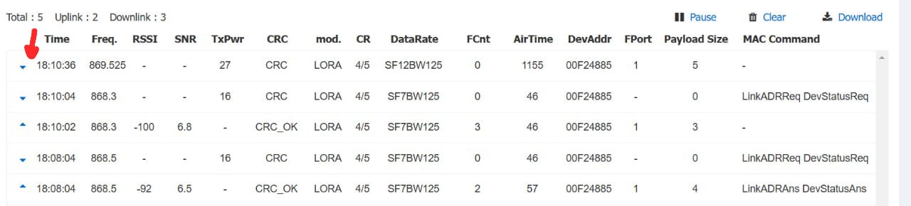

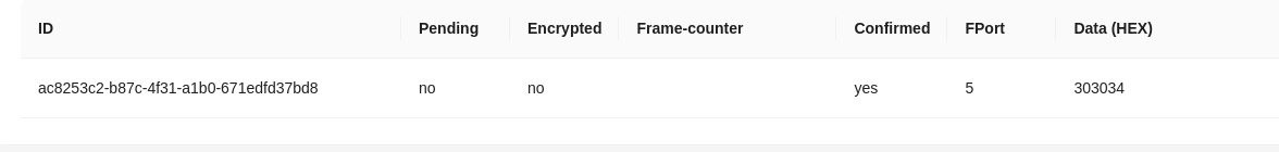

Not an expert on debugging this, but Iv started my testing from the “Queue” section in Chirpstack.
You can see the queue going from pending “no” to “yes” and the disaper after successful downlink transmission (you might need to refresh page to see changes).

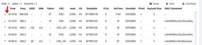

In gateway “packet capture”, you should see a type (arrow down) for downlink
