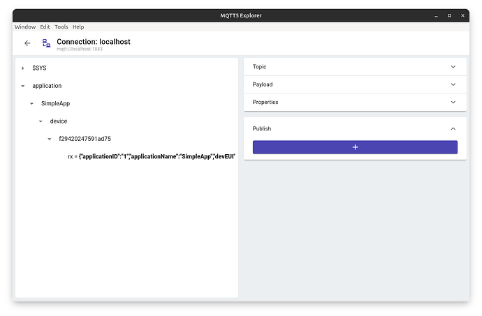

  • Built-in network server - runs the network server inside the gateway itself, allowing you to register your devices and uplink data can be delivered to the external MQTT broker
