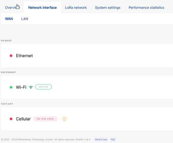

This issue is getting more confusing.

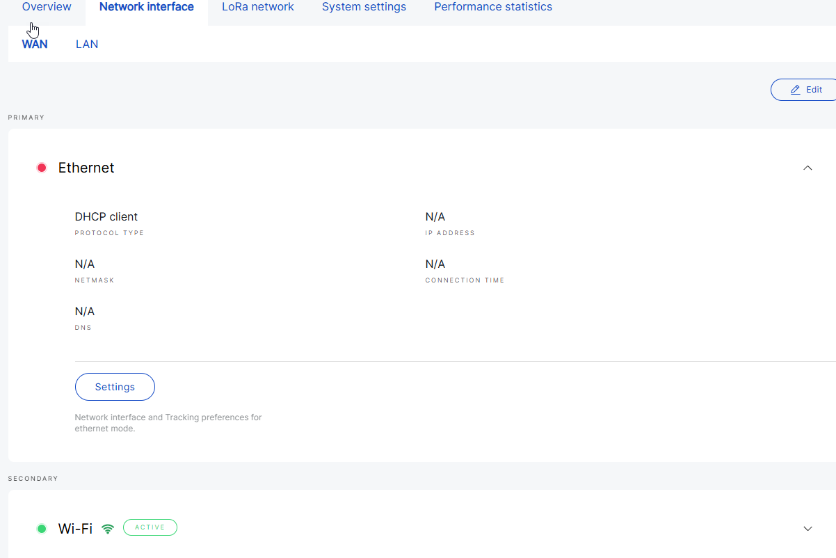

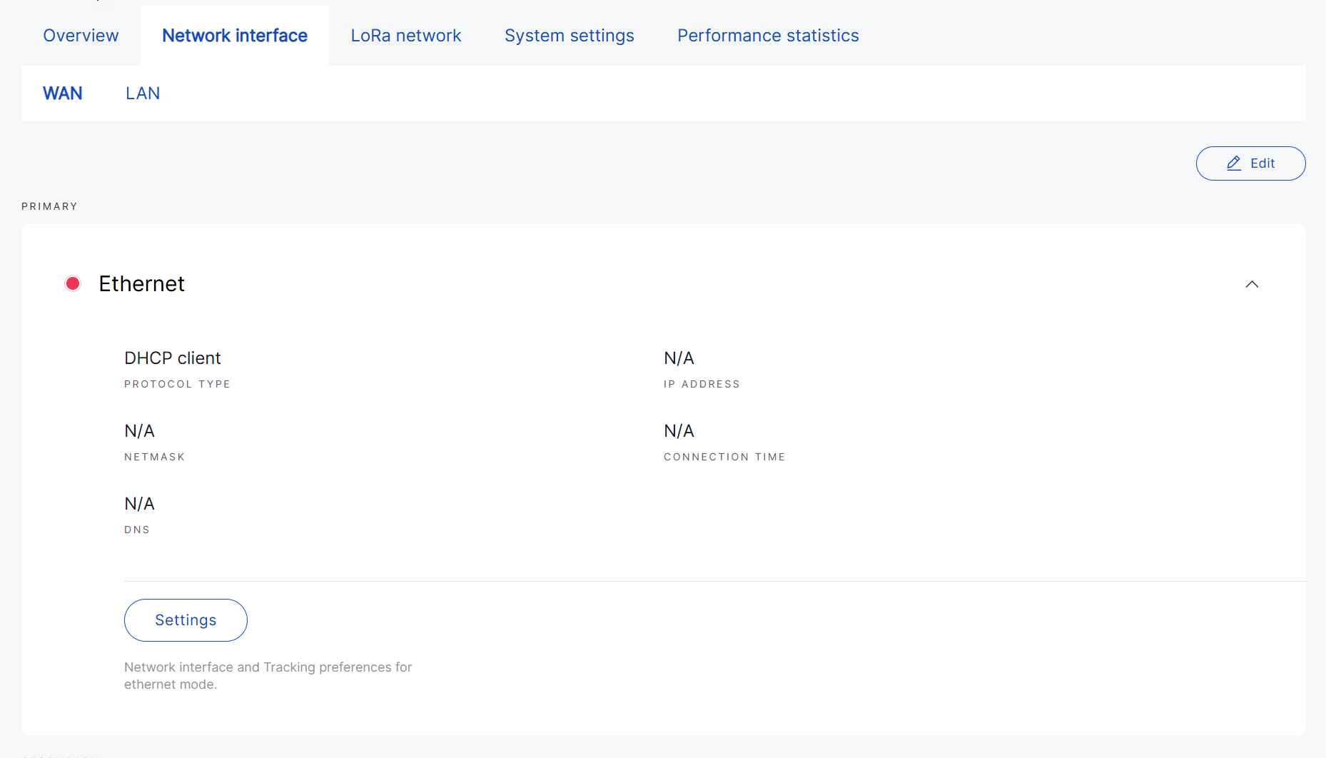

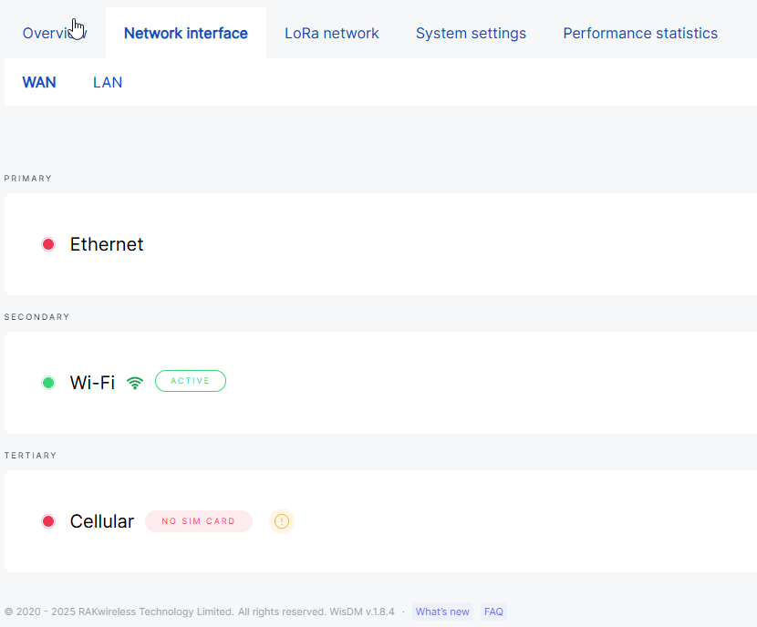

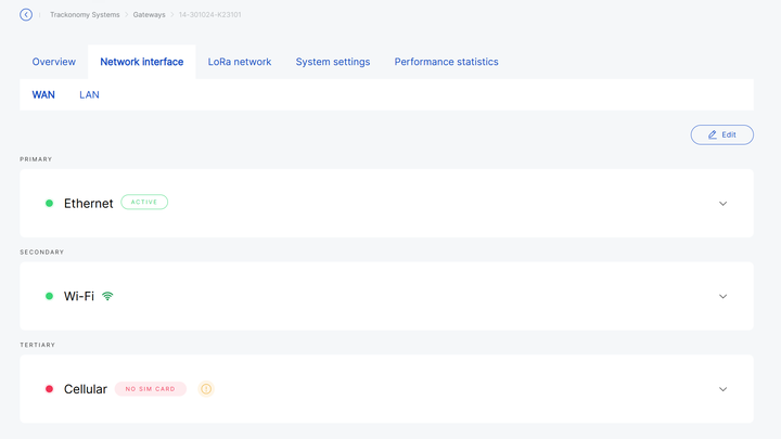

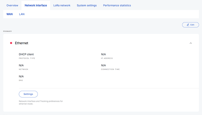

The 7268cv2 is drawing its power from the PoE switch port. The WAN setting has Ethernet enabled, DHCP client, Use DNS from router - but the Ethernet port continues to report itself as unavailable.
The WiFi interface has been configured to connect to the WLAN in place in my lab and the WiFi interface has associated to that WLAN and enabled the 7268 to connect to both WisDM and TTN successfully.
There appears to be something funky about the DHCP process on that 7268 Ethernet port, as other devices are able to receive a DHCP address from that PoE Lan switch port.
Confirmation that the 7268 has been offered a DHCP IP address on its ethernet port, but for some reason the 7268 is not binding it to the Ethernet interface

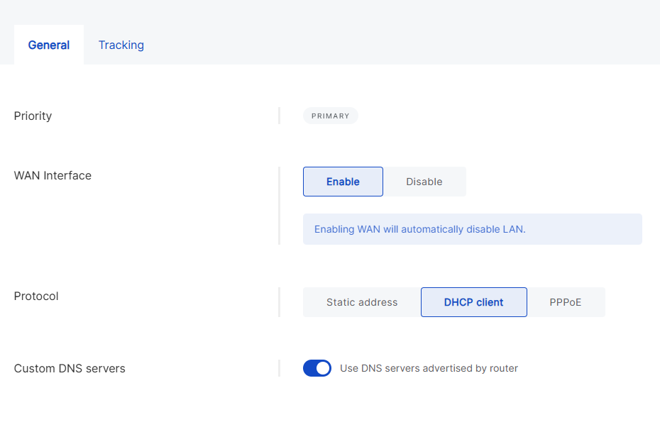

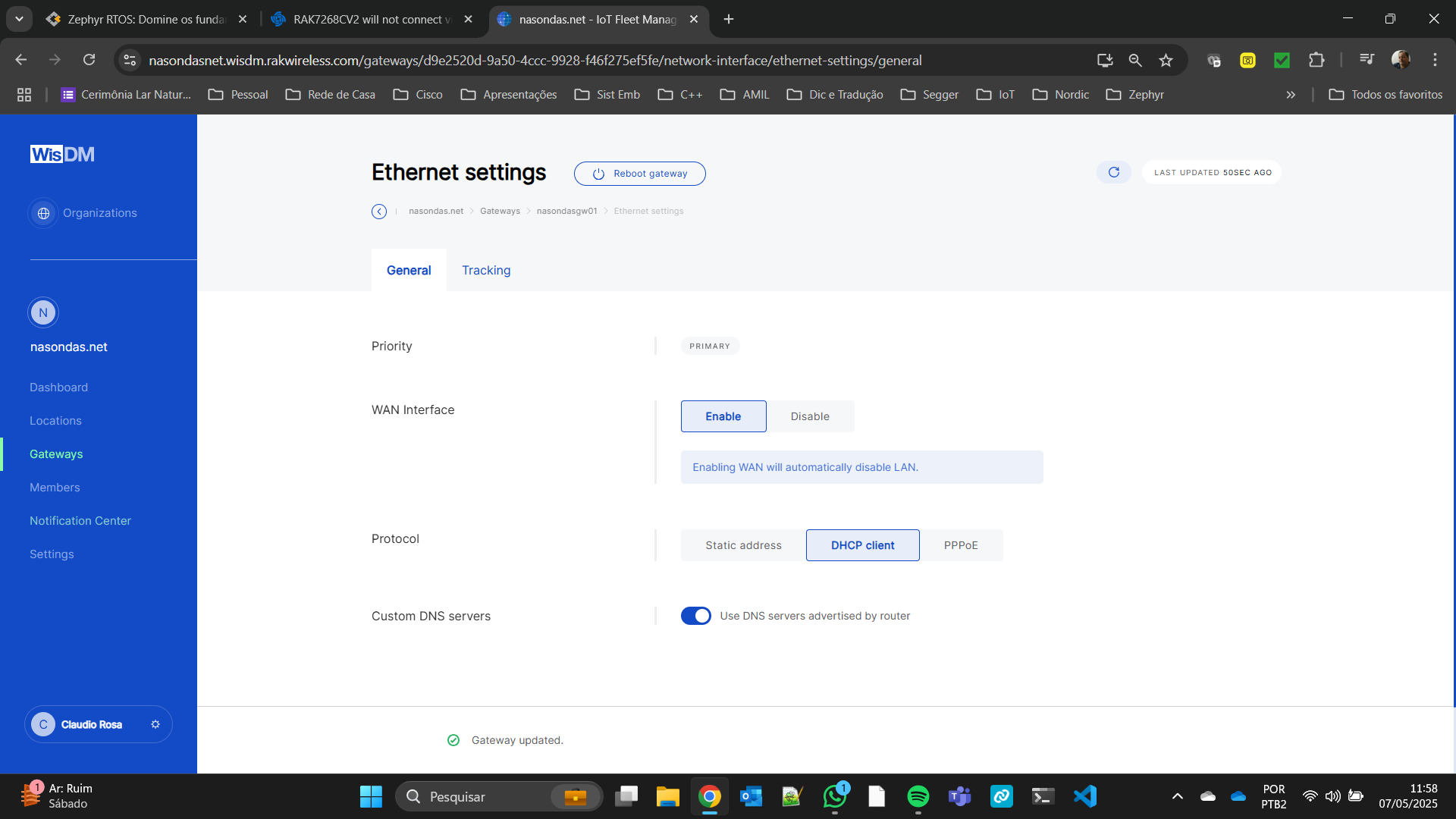

Hi,
Could the screenshot of Ethernet Setting page information?
Regards,
Claudio
Hi Claudio,
absolutely. Here is the screenshot of the WAN Ethernet settings screen

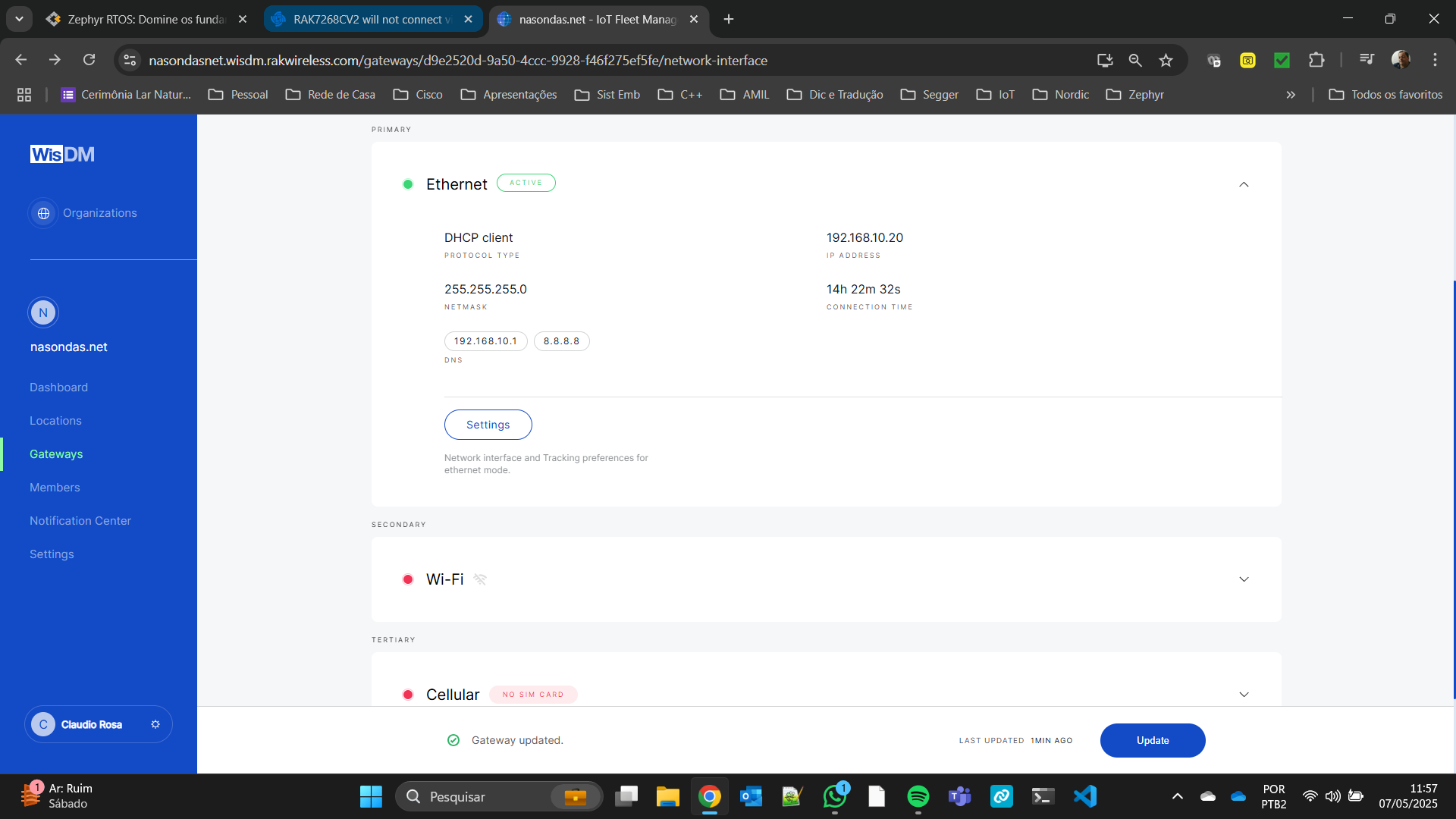

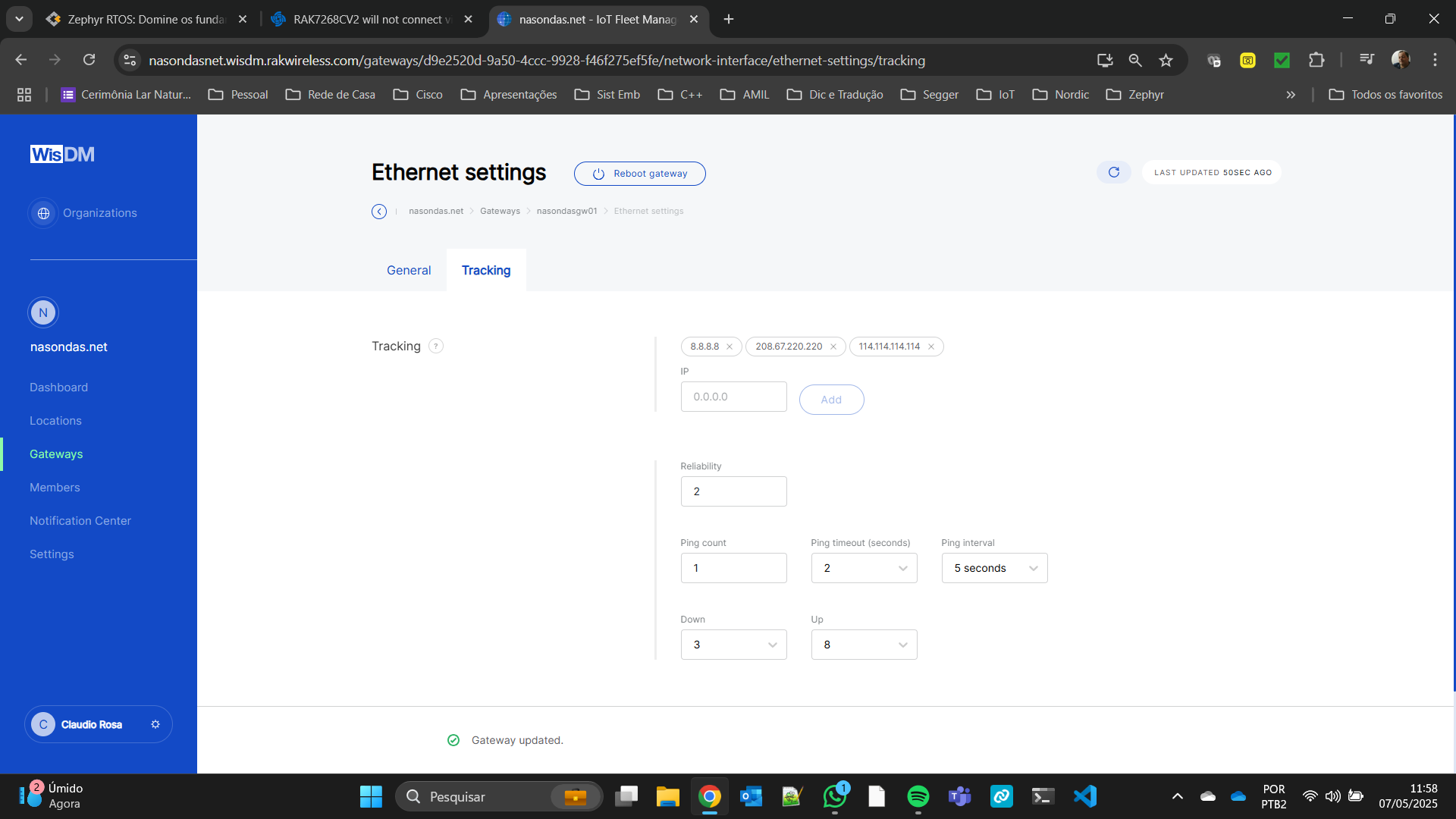

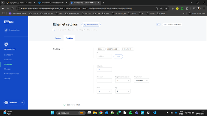

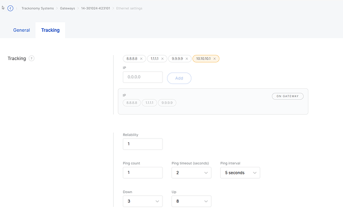

Hi Conrad,
Below you can see my gateway (RAK7289CV2) configuration. Could you get the your Gateway ethernet port Tracking configuration?
Maybe a wrong tracking configuration can make the interface as “down” because it is receiving a failure to reach the specified destination in the tracking feature.

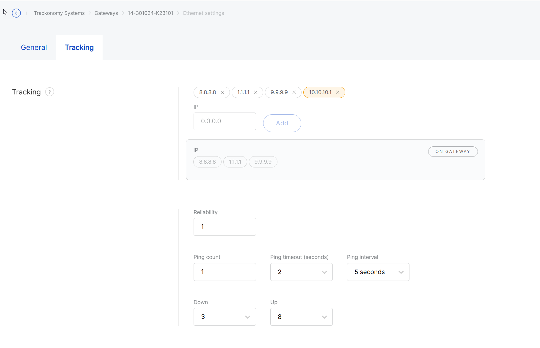

Hi Claudio, I have attached the WAN Ethernet setting and the Tracking. IMO, the fact that the DHCP client in the 7268 has not accepted the DHCP offer and bound the ethernet port to that IP address is why the Ethernet port is inactive.

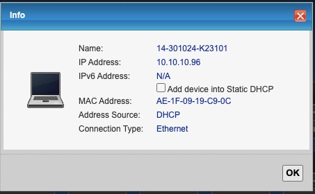

Actually, I just realized. The 10.10.10.96 address is the DHCP address assigned to the WiFi interface. So now I am wondering if the DHCP request was actually sent out via the ethernet interface.
Do we know if the MAC address for the WiFi and Ethernet interfaces are different ?

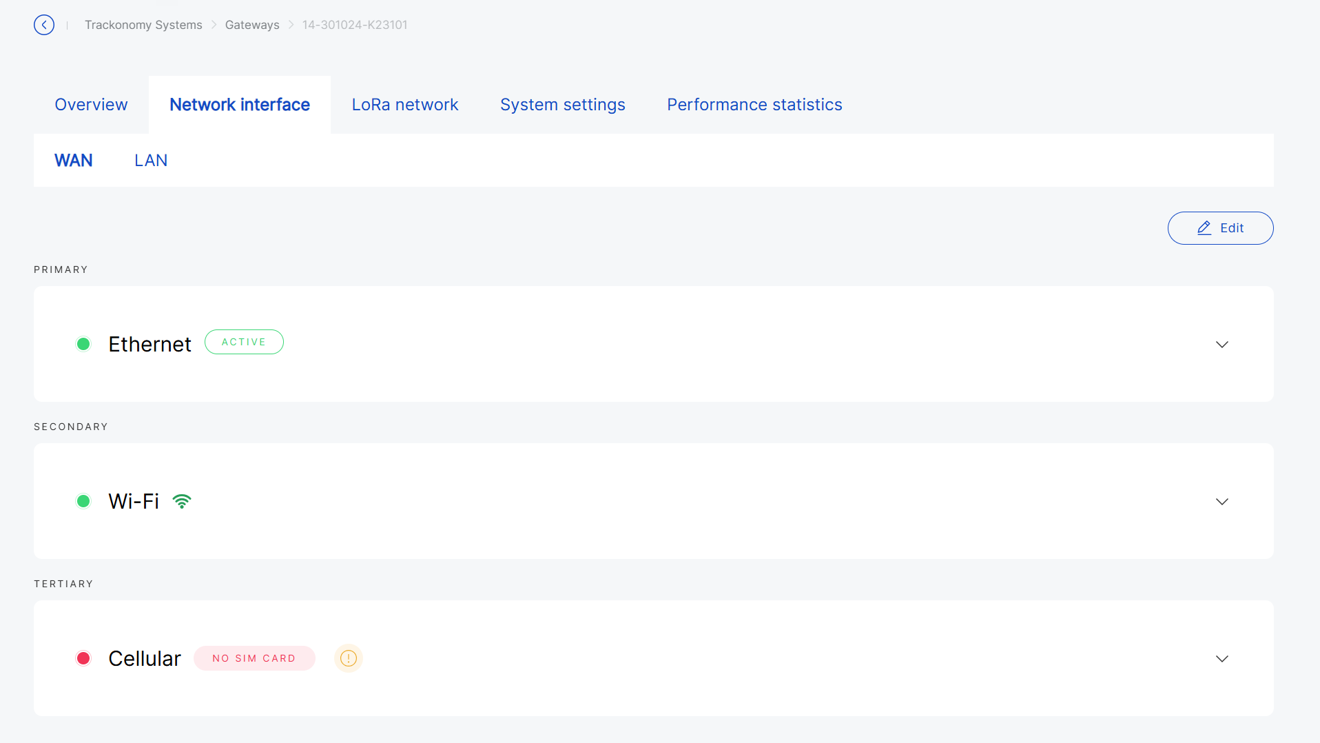

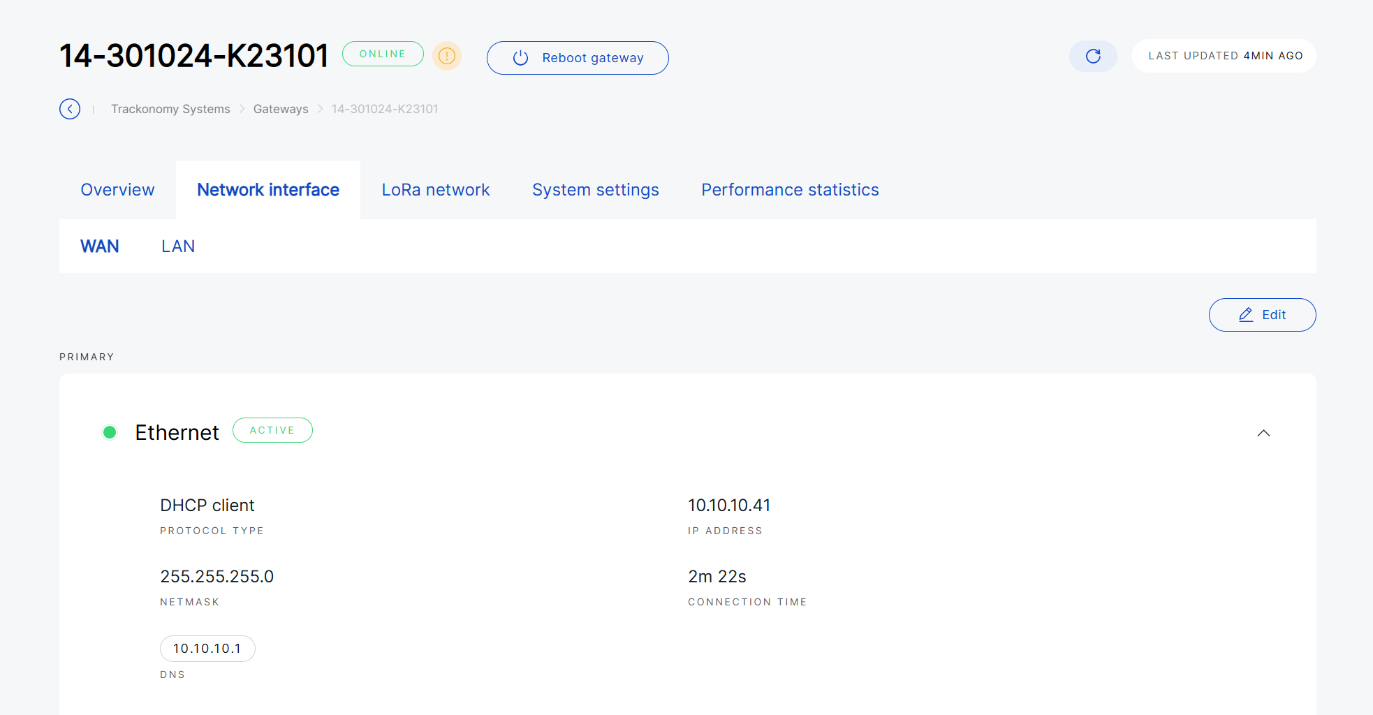

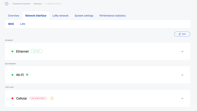

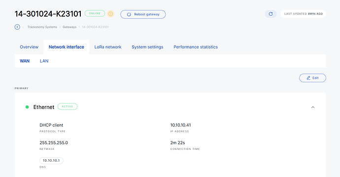

I decided to upgrade the 7268 from FW 2.2.8 to FW 2.2.11 and now the ethernet port seems happy.
I have both Ethernet and WiFi connected and active
