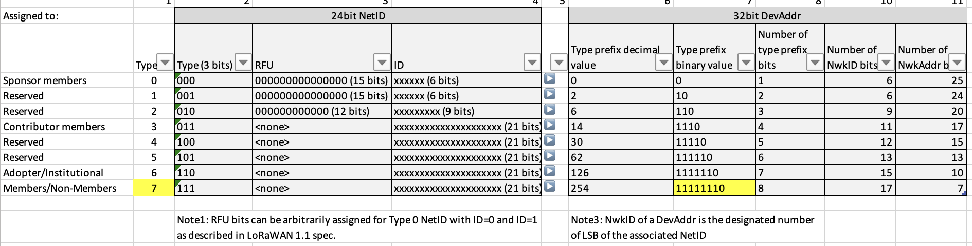

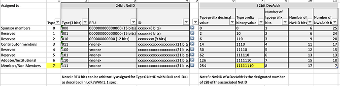

Our devAddr range is fe008800 - fe008fff. Both of these convert to 127 when using your formula for calculating the NetID. In fact 127 = 0x FE000000, which is the common prefix for ALL Type 7 Network IDs. This means that not only can we not filter within our own devAddr range, but we also can’t filter between our range and the devices of any other type 7 organizations that might be nearby.
Here is the table from the LoRa Alliance listing the NetID types. The highlighted binary prefix shows the problem - all Type 7 NetIDs are effectively lumped together, as you’re only using the first 7 bits:
As @j9archer already explained, the issue lies with the mask for the NetID. You could implement a similar approach to what’s used in the chirpstack-gateway-bridge.
