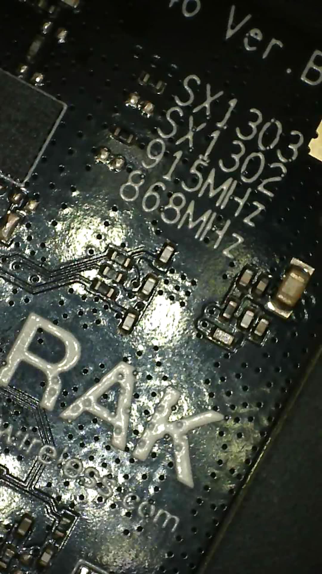

I find this in the concentrator, if change the resistor in Eu868 and change firmware?
This resistor is just for production marking of the device.
You will not change the actual frequency of the concentrator.
You would need a new concentrator to switch to 868 MHz.
