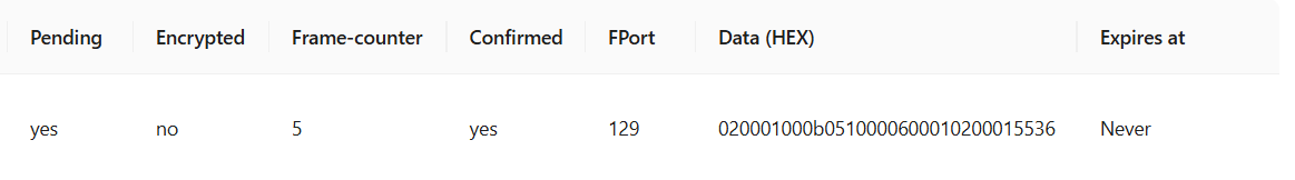

  1. Unable to do the same for 0x02: Transparent instruction / data
{‘devEui’: ‘ac1f09fffe189842’, ‘confirmed’: True, ‘fPort’: 129, ‘data’: ‘AgABAAsFEAAGAAECAAFVNg==’} (Deoded data - 020001000b0510000600010200015536)

But Node not receiving the dtu_command= 0x02
Anyone help on this?
