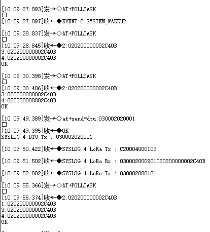

If the operation is correct, you should receive the following log:

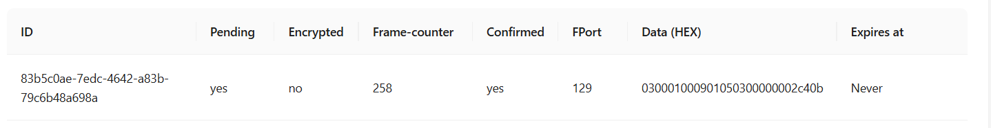

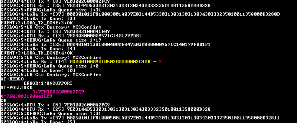

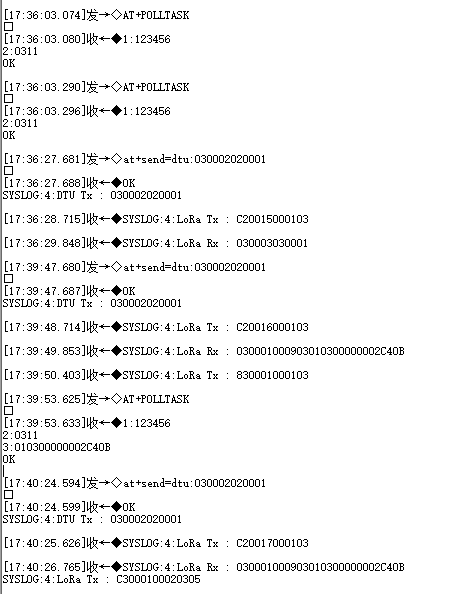

I have reviewed the current polling task configuration on the device, and I can confirm that Poll Task IDs 3 and 4 are active and functioning as expected. However, ID 1 appears to be empty and has not been assigned any task.
please see the attached screenshot which shows the current poll task list and the downlink message to add the poll task id 1 .
Thank you for the follow-up and for sharing the screenshot of the current polling task list and the downlink message.
After reviewing the information, we would like to confirm a few key aspects to help isolate the issue:
Observations:
  • According to your screenshot, Poll Task ID 1 is currently empty, which indicates that the task was not successfully created.
  • The downlink message format looks correct in terms of structure and payload.
  • However, based on the logs from the RAK7431, it seems that the downlink command was not recognized or parsed correctly by the device, since no task was added, no uplink was generated, and no error message was returned.

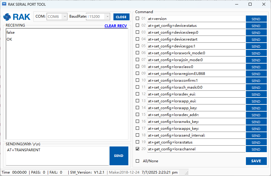

  1. What is the device’s transparent mode status?
    Please run the following AT command on the RAK7431 and share the output:
AT+TRANSPARENT
  • It must return false for DTU commands to be recognized and acted upon.
Hi @Nicholas,
Thanks for your response, here is the RAK 7431 configuration, all configured as per doc.
this confirms the DTU command sent to port 129
Non Transparent mode
CLASS C Device

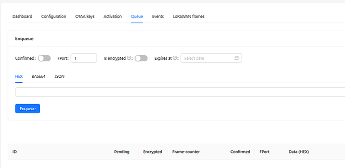

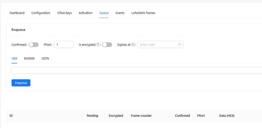

Send the same command via the ChirpStack Web UI
  • Please navigate to the device page in the ChirpStack UI.
  • Use the “Send command” or “Downlink**” feature.
  • Set fPort to 129 and use the same HEX.
  • Submit the downlink and monitor the device log for any response.
This will help confirm whether the issue is related to the backend API method or with how the payload is delivered.
