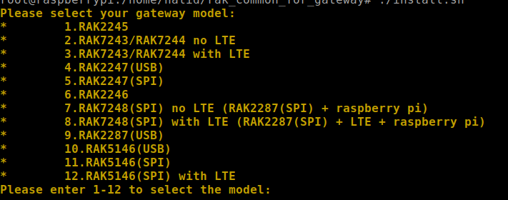

Repo: rak_common_for_gateway
However, we have some problems;
I selected 7 in the installation (7.RAK7248(SPI) no LTE (RAK2287(SPI) + raspberry pi))
