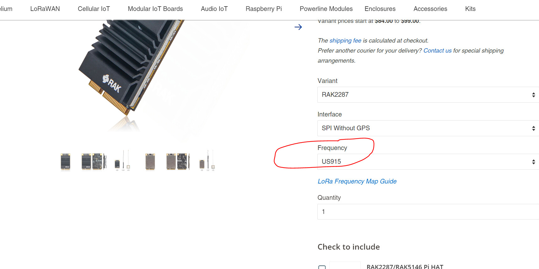

RAK2287 have different RF frontend for 8xx Mhz and 9xx Mhz regional bands.
If you are using US915 and AU915, that is ok and you will have no issues since the RF of those concentrators covers those frequencies. You cannot do that for EU868 and US915/AU915 since frequencies are different.
With regards to frequency, you can configure that on the packet-forwarder settings. And again AU915 and US915 will just work fine.
@carlrowan Thanks for the confirmation.
So, for RAK2287, there are basically 2 different hardware/firmwrae, the 915MHZ one and the 868MHZ one. Other than inspecting the chip visually, Is there a way to tell the frequency through API ?
