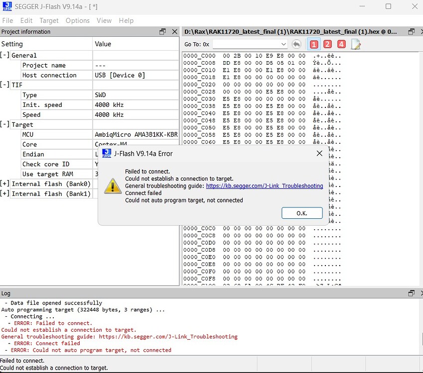

We are currently working with RAK11720 and RAK3172 LoRa modules in our project. During development, we encountered firmware-related issues where the modules are no longer responding correctly (AT mode and custom firmware upload are not functioning as expected).The error message is attached below.

You are talking about RAKDAP1 but your screenshot shows the JFlash application.
What are you planning to use?

we are going to use RAKDAP1 only, not with JFlash, whether it is suitable? Also in that picture it shown JLink because we used that but it doesn’t work.So we are planning to use RAKDP1
