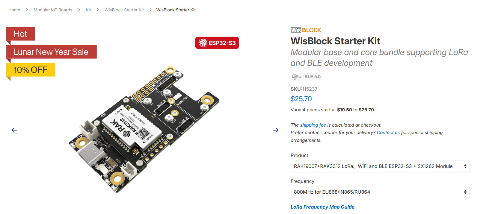

Or get the WisBlock Starter Kit with the RAK3312.
The WisBlock Starter Kit is cheaper, because it does not require the license fee that Meshtastic is applying.
