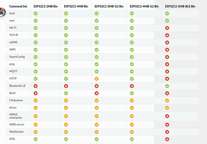

  1. According to Espressif’s AT command documentation, the ESP32C2-2MB binary supports Wi-Fi but has Bluetooth LE disabled, while the ESP32C2-2MB-BLE binary supports Bluetooth but has all Wi-Fi protocols disabled. Since the RAK11160 only has 2 MB of flash on the ESP32-C2 side, how does RAK provide support for both simultaneously?

  1. There is no combined AT FW that supports WiFi and BLE simultaneous. Here’s the BLE AT FW - esp32c2-2mb-ble-at.zip (4.8 MB). Complete list of ESP32 AT FW build here.
  2. We do not have a FW that unify it. Combining both WiFi and BLE stack on the limited RAM is the restriction. You can probably write a custom FW to create a leaner approach compared to the default ESP32 FW. If it will work with ESP32C2 RAM, I have no idea.
