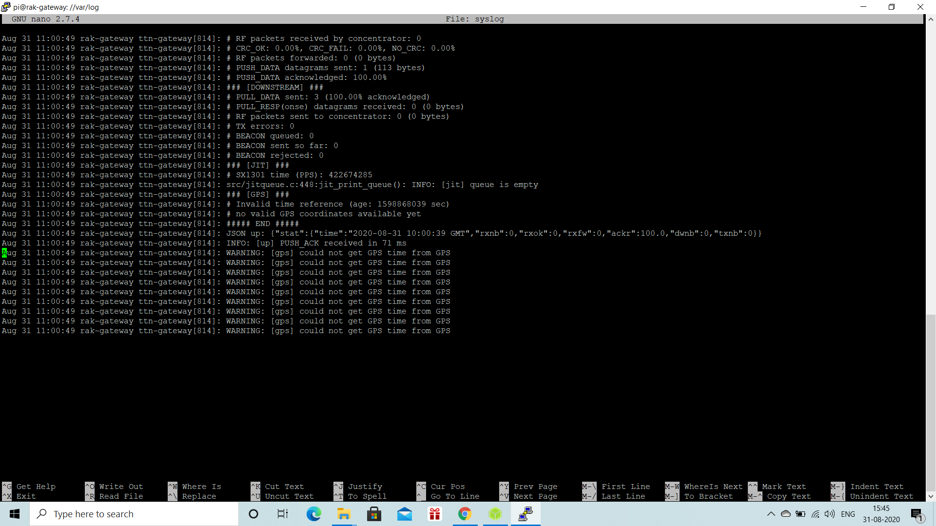

My RAK 2245 PI HAT based gateway is not showing up on the network(it says last seen three days), i worked on it on friday and just reconfigured the image file of RAK2245 to be sure, but it still shows last three days ago.
I checked the log Files but there is nothing after 11, what can be the issue?

There is nothing in the logs indicating an issue with your connection to TTN. If you search the TTN forum you will discover that the web console update is very unreliable at present. You should use a device to trigger an uplink and then check it has arrived.
