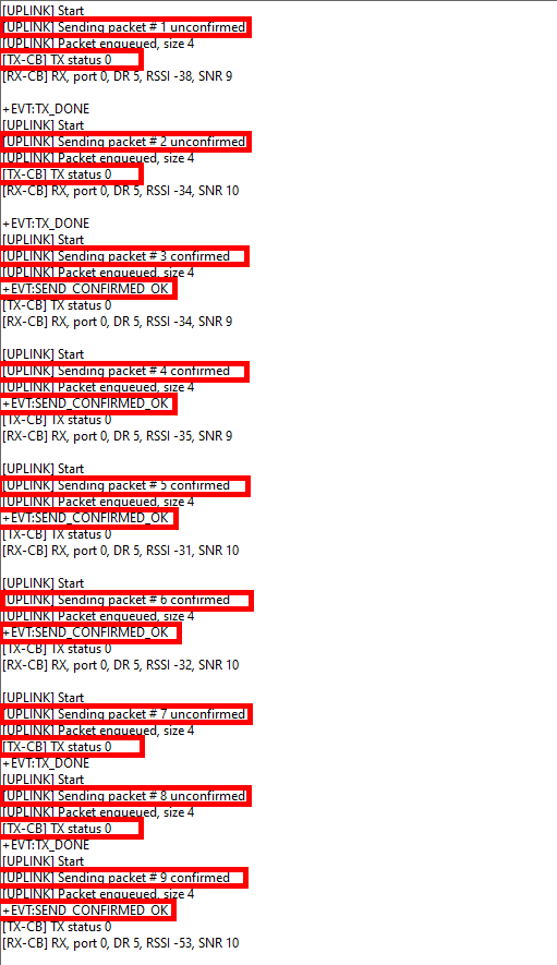

But when my program on occasion does a “non-confirm” send as follows:
api.lorawan.send(data_len, (uint8_t *) & collected_data, LoRa_fport, false);
if(LoRaDebug){Serial.println(“Sending STATUS without Confirmation”);}
// The above works, giving serial output of:
sendCallback
+EVT:TX_DONE
However, the next attempt and subsequent attempts to send data via the confirmed uplink mode fails (serial printout of “Sending Data Start failed”) from the next occurrence of:
if (api.lorawan.send(data_len, (uint8_t *) & collected_data, LoRa_fport, true, 6))
tx_active = true;
else
tx_active = false;
Serial.println(“Sending Data Start failed”);
